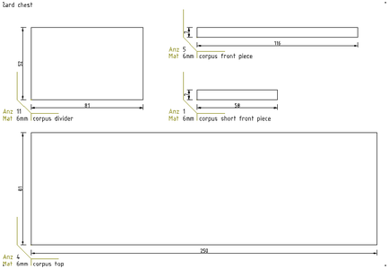

For the chest I used poplar plywood and a bar made of spruce. Sizes and quantity of the smaller parts are in the drawings in this step. The bigger pieces are all simple rectangles, so i just made this part list:
piece               material   depth  length   width     quantity
bottom/top plate    plywood    6 mm   360 mm   250 mm    2
side piece top      plywood    6 mm   262 mm   163 mm    2
back piece top      plywood    6 mm   360 mm   83 mm     1
front piece top     plywood    6 mm   360 mm   52 mm     1
back piece chest    plywood    6 mm   360 mm   80 mm     1
front piece chest   plywood    6 mm   360 mm   111 mm    1
back piece corpus   plywood    3 mm   250 mm   117 mm    2
double bottom       plywood    6 mm   249 mm   177 mm    1
holder (bar)        spruce     15mm   56 mm    (round)   2
dowel (bar)         beech      6 mm   20 mm    (round)   2
lid outer parts     plywood    6 mm   4 mm     80 mm     2
lid inner part      plywood    6 mm   4 mm     162 mm    1
latch background    spruce     2 mm   20 mm    25 mm     2

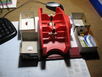

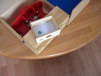

I got the basic measurement for the drawers from the card shuffler. I chose 45 mm as height to fit a card game with about 100 cards in it. I had to add some space in length and width for a better usability and to get German playing cards into it. I also wanted do add finger holes to the bottom to get better access to the cards and a finger hole into the front as alternative for the handle. To get the final measurements I made cardboard boxes to try it out. After a few tries I got the perfect size.
After that I was able to define the final sizes for the chest itself. The basic measurements of the chest are based on my own clipboard for DIN A4 paper. According to earlier ideas I arranged the card shuffler into the centre and the drawers to the left and the right. The final depth of the chest are the width of the two drawers plus the material for the corpus. The final width is the size of the two corpus plus the card shuffler with attached crank lever.
The right order
The next issue was the dimension of the corpus. I didn't know how to get the dimension for sliding the drawers in and out easily. For this reason I started with building the drawers and corpuses first. With the first corpus and the first two drawers I was able to test the functionality before continuing and building the remaining chest around of them. Unfortunately this method caused more scrap wood but I think I can use it on my next project.

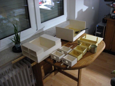

Step 3: Drawers and Chest Interior
Drawers

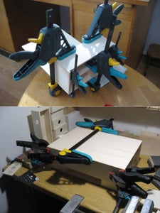

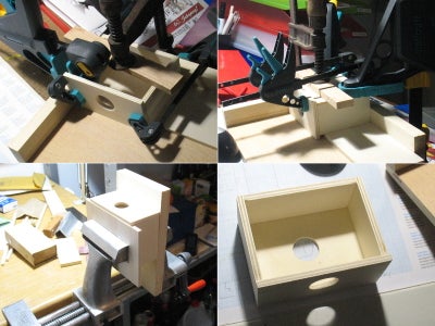

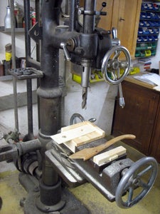

When cutting the pieces on my table saw and drilling the finger holes with a 25 mm drill on the big drill press it came in handy to print out the sketches in the right size. Thus it was very easy to check and sort the 71 pieces for drawers and corpuses.

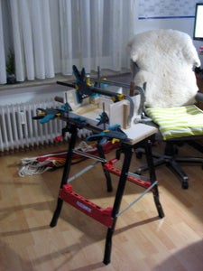

For gluing I made a jig which is a simple board with two slats screwed on it. I used it for gluing the pieces in the back and side pieces in a right angle. Then I clamped them onto a scrap piece so I got the right height to attach the front piece. The bottom strips aren't complicated, but the bottom piece itself, which I had to attach properly to the front.
Corpuses
Next came attaching the dividers to their tops to get corpuses. For the divider in the centre I used two drawers and some old bonus cards to get them exactly placed. I finished the four drawer spaces first before attaching the upper to their lower ones. Then it was possible to attach the front and back pieces.

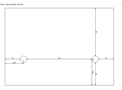

Double bottom

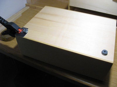

The double bottom was the last piece glued together, when the chest was finished and I was able to check the measurements a last time. To get the bars holding the card shuffler on their places I drilled 6mm holes into the bars and the bottom and attached them with the help of two 6mm dowels. To keep them straight while gluing I used my drill bit jigs.

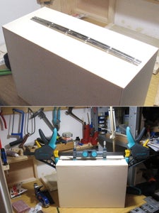

I began with the lower half of the chest. The cuboid shape of the corpuses helped a lot to get it straight. The top was harder to assemble. You have to make sure to get the right angles by yourself.
The first fitting revealed it didn't work well: The top recessed a little bit against the bottom instead of closing accurately to it. Thus I made a lid from a 6 x 4 mm plywood strip with two spruce pieces as spacer for the latches. The lid covers the ledge very well and it is now easier to open the chest. I think I can call it a successful kludge.
First assembly
Before I made the kludge I mounted a piano hinge. Thereby I was able to fit the top perfectly to the chest. I made the top a little bit too narrow. I had to sand down the sides of the bottom a little bit so it would close smoothly.
After adding the lid I installed the latches. At this point it was possible to make pencil marks and I could check if it is all working before I made the finishing. When I was sure that everything would work on the final assembly I removed the metal parts to make the finish.

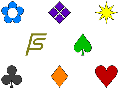

To get the drawers distinct from each other I decided to add a logo to each front. So I chose some symbols out of the utf8 table:
  • BLACK SPADE SUIT (♠)
  • BLACK CLUB SUIT (♣)
  • BLACK HEART SUIT (♥)
  • BLACK DIAMOND SUIT (♦)
  • BLACK DIAMOND MINUS WHITE X (❖)
  • BLACK FLORETTE (✿)
  • EIGHT POINTED RECTILINEAR BLACK STAR (✷)
Inkscape got me the best symbols with Courier new. I coloured the card symbols according to German suit colours. The other symbols were inspired by the swizz suit, although it is a little abstract now. For colouring I just allotted the missing colours of the chromatic circle.

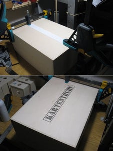

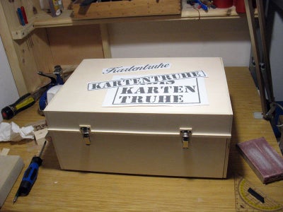

I decided to write the name of the birthday child and "Kartentruhe" (literally "card chest") onto the chest. For better visualisation I took some fonts and printed them out and put them directly on the chest. I decided in favour of Top secret for the "Kartentruhe" and Birds of Paradise for the signature. At last I got a place for my personal logo underneath the double bottom.
Transfer
There are some methods for toner transfer. I made some tests (ok, I have nearly no scrap wood with logo now) and found out the most reliable method for my purposes.
First I printed out the writings mirror-inverted and with full colour activated (no economising here) on my laser printer. It is useful to get enough border around them, e.g. I made the borders for the card symbols matching to the drawer fronts so placing them was easier. I used my clamps to fixate the paper onto the surfaces. Then I took a spray can with universal thinner and a cloth and sprayed some thinner onto the paper and pressed it onto the surface with the cloth. The simple fixation allowed me to check the transfer without getting the paper out of position and to repeat it, when necessary.

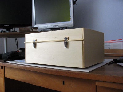

After that I was able to mount the metal parts and the velcro. Because I already had all the screw holes on the right place it wasn't very challenging to get it all together. As feet I used some furniture gliders. First I thought about nailable ones, but then I got some to screw on.

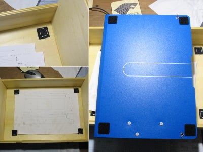

Next came the clipboard. I got some self-adhesive velcro which I first attached on the clipboard. First I tried to set the counterparts on the clipboard as well and press it altogether into the top, but this doesn't work on a freshly oiled surface. So I took a sheet of paper helping to position the counterparts and took a stapler to attach them.
