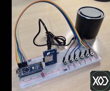

Introduction: Playing Wave File Using Arduino
This is a simple circuit to play wav files using arduino Nano V3.0 ,it consist from 4 buttons ,each one play specific wav file loaded to SD card.
Step 1: Parts
1- Arduino Nano V3.0 (I used the chines version called Funduino Nano).
2- SD card Module.
3- SD card.
4- Bread Board.
5- four push Button .
6- four 22K resistors.
7- one 4.7K resistor.
8- BC546B NPN transistor.
9- Speaker.
10- wires.
Step 2: Prepare Your SD Card
1- Format SD card and make sure the setting as attached picture.
2- Convert your music to .WAV files and make sure the below:
-Samples Per second(Hz):16000
-Channel :Mono
- Bits Per Sample: 8
I use Wav Sample rate converter software (picture attached).
3- Wave files samples attached.

Step 5: Troubleshooting Update 29/5/2016
For people whom unable to make this circuit work ,I created the attached folder "for test" for troubleshooting purpose .
The folder includes tested code for Arduino Nano ,UNO and MEGA.
No need to connect the push buttons,the sounds will play automatically.
No need to connect the transistor ,Connect a small speaker or headphone directly to pin 9 for arduino nano or pin 11 for Mega .
Copy the .wav files directly to SD card ,Do not put them inside folder.
Pin Connection:
Arduino Nano ---------> SD Card
12 -------------------> MISO
11 -------------------->MOSI
13 -------------------->SCK
4 ---------------------->CS
9 ---------------------->Speaker
GND ------------------>GND
5V ------------------> VCC
Arduino MEGA ---------> SD Card
50-------------------> MISO
51-------------------->MOSI
52 -------------------->SCK
53---------------------->CS
11---------------------->Speaker
if the tested code worked fine do the following for the push buttons code file to make it work:
1-If you faced problem in compiling the original push buttons code file ,please add line #include<SPI.h>
in the 3rd line of the code.
still have no sound add a delay command between the play commands delay(1000);
Good luck
