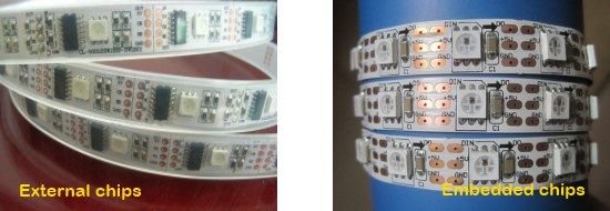

Some strips are addressable or digital: those strips include some control chips that allow to drive each led independently from one another. Sometimes the chips are visibile, sometimes they are embedded in the leds:
It’s very important to distinguish the strips according to the number of independent leds: the cheapest ones use a single chip to drive 3 leds. Sometimes in the datasheets you may read about the number ofpixel: a led strip with 30 leds/m and 10 pixels/m is a strip with only 10 chips, each of which drives 3 leds; so you can cut the strip only every 3 leds.
