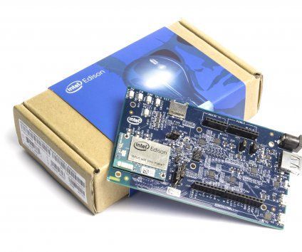

Introduction: Playing Music With Your Intel Edison
Who else loves music? I bet those who do will find this Instructable interesting and fun to do. There are so many single-board computers that we all have and love including Raspberry Pi, Beaglebone and now the Intel Edison. These computers really are computers, in that they run a full operating system, Linux. In this Instructable, I will be guiding you in setting up a mp3 player on your board and playing music via external speakers using a USB sound card. These steps may or may not work on other boards like the RPi or Beaglebone.
Also, I want to thank Intel for selecting me and 99 others to receive an Intel Edison board. Thank you!

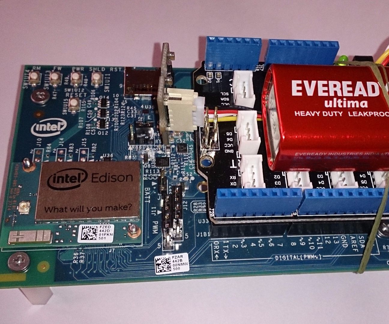

Step 1: Getting Ready
Most of the Intel Edison tutorials and projects uses Edison in the device mode. Here I will be using it in the control mode. This will let the board control the USB port.
For switching to control mode flip the small switch beside the USBs port towards the large USB port and power supply port. Now power it up using a 7-15v power adapter.
Now that it in USB mode, connect the serial port to your computer and access the linux system of Edison using PuTTy.
Note: If you are a MAC or linux user then no need to use PuTTy.
You can downlaod PuTTy from here - http://www.putty.org/
