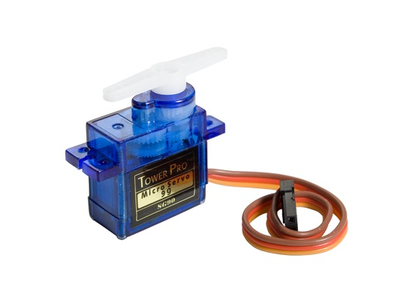

Servo-motor
A servo motor is a small motor that moves to a specific angle or position based on a control signal. It is commonly used in robots, RC cars, airplanes, and automation systems.

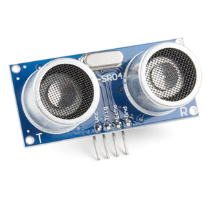

HC-SR04
The HC-SR04 is an ultrasonic distance sensor. It uses sound waves to measure the distance to an object — kind of like how a bat "sees" in the dark!

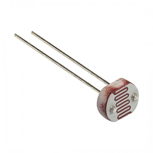

LDR
LDR stands for Light Dependent Resistor — also called a photoresistor. It is a sensor that changes resistance based on light: More light = less resistance, Less light = more resistance. So, it's used to detect light levels (like day/night).

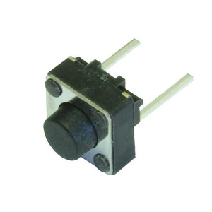

BUTTON
A button is a simple electronic component that acts as a switch. When you press it, it closes the circuit, allowing current to flow. When you release it, the circuit opens again.

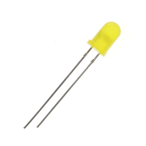

LED
LED stands for Light Emitting Diode. It’s an electronic component that lights up when electricity flows through it — but only in one direction.

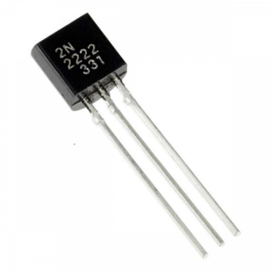

Transistor
A transistor is a small electronic component that works like a switch or amplifier. It can control a large current using a small signal.

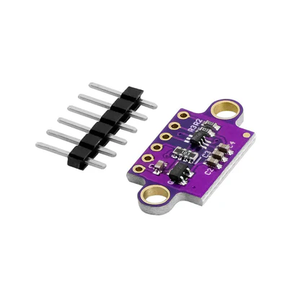

VL53L0X
The VL53L0X is a time-of-flight (ToF) distance sensor made by STMicroelectronics. It can measure very accurate distances using laser light — even better than an ultrasonic sensor like the HC-SR04.

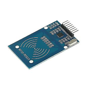

RFID
RFID stands for Radio-Frequency Identification. It’s a wireless technology that allows you to identify and track objects or people using radio waves.

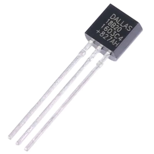

DS18B20 Temperature Sensor
The DS18B20 is a one-wire sensor that measures the temperature, manufactured by Maxim Integrated. There are 2 sorts of DS18B20 sensors, the component only (Which I used) and the waterproof version, which is much bigger, but that’s not what I needed for my project, so I used the component only. The sensor can measure the temperature in a range of -55°C to +125°C (-67°F to +257°F) and it has an accuracy of 0.5°C from -10°C to +85°C. It also has a programmable resolution from 9 bits to 12 bits.
Datasheet: https://datasheets.maximintegrated.com/en/ds/DS18...

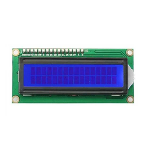

LCD Display 16x2
I used a basic LCD Display to print my temperature, volume and IP address.
Datasheet: https://www.engineersgarage.com/electronic-compon...
