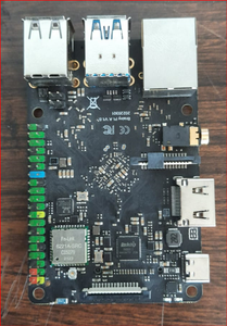

Plex is a client-server setup where the client directly streams data from the Plex media server. This setup means you can have all your movies, music, and photos located on one device, the server. In this case, we will be using BrainyPi.
You can set up your own plex server with only a few steps
Brainy Pi

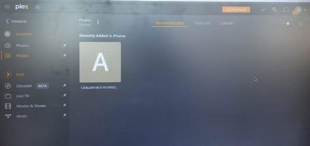

Step 3: Web Interface
1. To access the web interface you have to get IP address of your Brainy Pi. To get the IP address you can use the command
hostname -I
If you get multiple IP addresses no need to worry that is because you have not set a static IP address. You can use any one of the IP addresses.
2. Now go to your favorite browser and search for
IPADDRESS:32400/web/
3. You can add the files and libraries by going to option {Add library}
4. Once you add the library, it will now organize your clips in a nice easy to browse interface.
5. You can explore the web interface on your own now and you will get to know more features of the plex server
