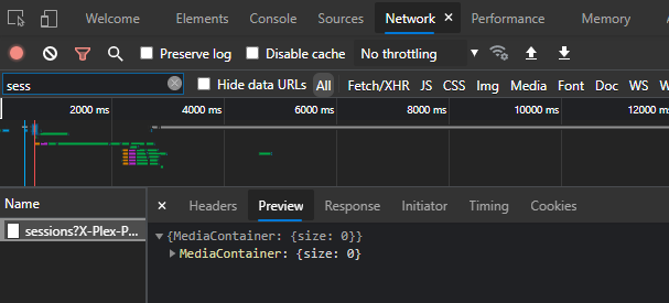

Step 3: Get the Sessions Call
  1. Open up the network tab in dev tools.
  2. Navigate to your plex server url.
  3. Look for the sessions call (in the image i used the search)
  4. Click the sessions call, if you see what I have in the uploaded image that is the correct call.
  5. Right click this call and copy -> copy link address
