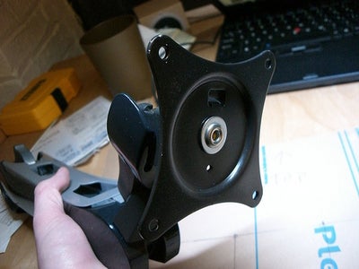

I bought a VESA mount arm from Ergotron. I wanted to be able to reposition my laptop for better ergonomics but I wanted to be able to still use it as a tablet (possibly while standing). There are several VESA mount options for laptops, but none seemed to suit my needs. I decided to build this out of Plexiglas and several screws with nuts and washers. Here's what you'll need to build this

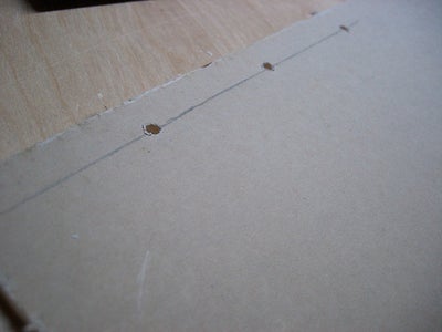

Using your measuring device put markings for four holes in the bottom edge of the large piece of Plexi. I centered them and spaced them 2" apart.

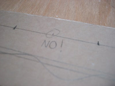

You will need to put three holes at the top as well. On my laptop there is a GSM modem antenna which makes the top uneven. I chose to put the three top screws off to the side so that it would not interfere or put any load on the antenna. YMMV depending on your laptop.
I also used the laptop itself to determine the placement of the holes. This was easy and helped me to make sure that the laptop would fit in the final product.

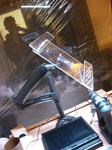

Step 5: Attach the Small Pieces of Plastic, Insert Laptop, Enjoy Better Posture

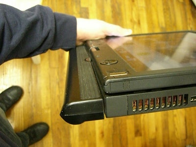

Attach the smaller pieces of plastic to the larger one using the rest of your screws. Do not tighten them very much. Slide the laptop in and tighten things up for a snug fit.
Read the manual for the VESA arm you have. You may need to adjust the arms tension depending on the weight and position of your laptop. You should also position your laptop so that you are comfortable and in a neutral position. It's good for you.
