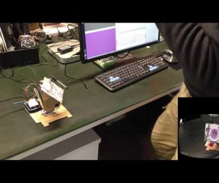

Introduction: PlotClock_zoomIn_LOT
Base on Plotclock by joo
Thanks to joo, Johannes Heberlein and other maker! ~(^◇^)/ (┌・ω・)┌✧
A larger version of the Plotclock. use microcontroller board of LOT. In addition to drawing and writing, you can also click the mobile phone.
I did these changes:
  • Zoom in about 2 times;
  • The range of draw is large enough to cover the many phone screen;
  • Bearings were added to the rotating parts;
  • Replaced the bigger servo;
  • The frame is redesigned and laser cut;
  • Microcontroller board was replaced with NodeMCU-32s;
