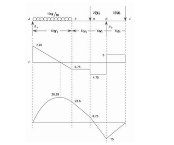

This is the question we will work on:
Question: A Beam 25 m. long is supported at A and B and is loaded as shown above. Sketch the SF and BM diagrams.

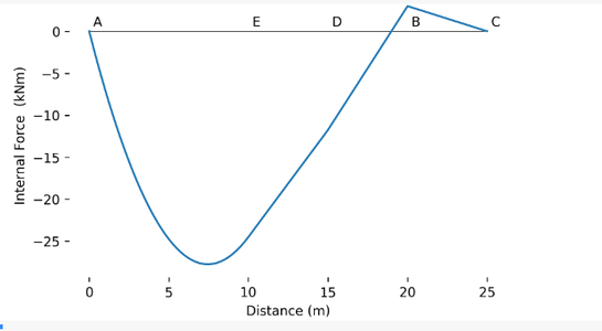

Step 6: Shear and Bending Moment Diagram
# instantiate the analysis object
analysis = ps.OpenSeesAnalyzer2D(beam)
# Run the analysis
analysis.runAnalysis()
# Plot the ShearForce and Bending Moment Diagram
ps.plotShear2D(beam, scale = 0.0002, yunit = 'kN')
ps.plotMoment2D(beam, scale = 0.0002, yunit = 'kNm')
Step 7: Result and Conclusion
The picture above is the result from the textbook where I got the question from which is similar to my plot as shown in step 6.
