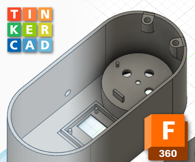

Step 3: Add Threaded Inserts to the Case
To make sure the casing of the smart plug and the Raspberry Pi is sturdy we will use threaded inserts and small screws to hold everything together.
Take a threaded insert and place it in one of the holes in the case. Next, grab a soldering iron and insert it's tip into the threaded insert. Gently push down untill it's flat with the case. Repeat this for all of them.
Step 4: Glue the Female Socket Sliding Mechanism
The female socket consists of 2 parts: a sliding mechanism and the socket itself.
Apply some superglue on the botton of the sliding mechanism, and place it on the backside of the casing's female socket. (All the holes should perfectly align with eachother.)
Take your soldering iron again and melt the little plastic holders on the sides flat. This should really bond the casing to the socket even more.

Step 8: Mounting the OLED Display
Make sure the OLED display has 90° pins on the back. If not, desolder the regular ones and replace them with 90° pins.
Check the display's pinout because you won't be able to read the top silkscreen anymore when it's mounted.
Drop the display in it's designated hole, the pins should be on the top side.
Flatten the corner pieces by using a soldering iron like you did before with the slide mechanism of the female socket.
