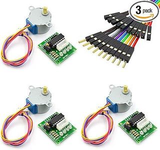

  1. Stepper Motor and Driver Board (3x)

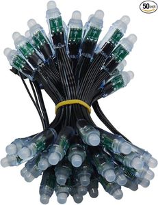

  2. Addressable 50x LED Wire

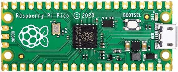

  3. Raspberry Pi Pico*

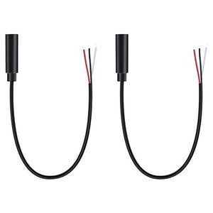

  6. Female Audio Jacks (x5)

Step 1: Setup Pi Pico + Upload Code
Before using the Rasberry Pi Pico, we need to set it up! I highly advise following this informative video by John Gallaugher. After your board is setup, upload the attached code file! Be sure to name it "code.py" or it will not work!

  3. Screw the motor holder into back side, such that the motor faces to the right.
  4. Feed the track in all the way.
  5. Attach the gear to the motor such that it aligns with the track.

Following the above wiring diagram to the best of your ability! I would also highly recommend labeling each of the audio cables, as from left to right they should be: A, B, C, Demo.
Similarly, the motor drivers are also from A, B, C from left to right.

Having (hopefully) marked the proper audio cables, you can now thread them through the labeled holes, and use a combination of hot glue and super glue to secure them! Be careful not to accidentally yank them out!
The remaining audio cable should be plugged into the speaker.
Step 10: Thread LEDs
Thread the LED cable between the containers such that they can stick into the label holes in the divider. The 4th, 7th, and 10th lights should be in C, B, and A respectively! Be sure to hot glue or super glue them in.
Next, feel free to staple remaining LEDs to the box top until there is no more room left! Any leftover LEDS can be just cutoff, the strip will still work!
Wherever you end up threading the LEDs, be sure to leave a notch such that the top can still close.
