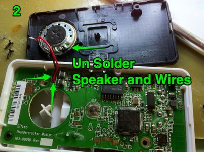

Step 4: Extricate Printed Circuit Board Assembly
Next step is to remove the printed circuit board from the plastics.
I've outlined what needs to be done into some sub-steps:
1. Remove the top plastic "grill" from the main body.
The best way is to get your fingernails underneath the plastic and pull. As long as you have removed the screws in the previous step it should pop off freely without much force. Be careful as to not pull too much, the speaker is still attached via two wires. We'll remove those in the next sub-step.
2. Unsolder the wires.
Fire up your trusty soldering iron. We're going to un-solder the wires from the speaker. It makes it much easier to work with the printed circuit board assembly (PCBA). It may be easier to remove the wires from the PCBA after you have followed sub-step 4.
3. Remove the screws holding the PCBA in the main plastics.
4. Remove the PCBA.
Now with your pointer finger pry the PCBA from the base plastics where the round hole is in the printed circuit board (PCB). You may need to give it a good tug to expel it from its previous home.
