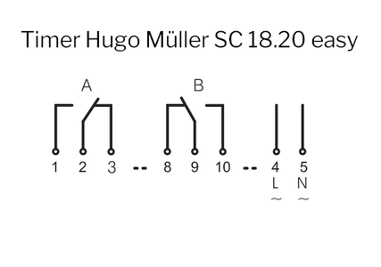

While the centre piece is the digital timer SC 18.20 EASY, it needs to be wired and housed appropriately. Most importantly, industrial devices such as this are meant to be mounted with known L (live) and N (neutral) power wires. Since we want to put this into a box that can be attached to a wall socket, a problem arises: The Schuko plug we're going to use doesn't guarantee the right orientation. Of its main two pins, we don't know which is L and which is N. Ideally we should use the timer to switch the live wire, but we may end up accidentally switching the neutral wire instead, if we do not take further precaution! This would be dangerous, as an open live wire could end up in an appliance, possibly causing a shock when one touches that appliance.
Step 2: The Improved Circuit
I asked around, and more competent folks told me I should “use a second relay which breaks both live and neutral wires”. After a bit of head scratching, this is actually quite simple conceptually. The power input of the timer shouldn't mind which is the N and which is the L wire. We still use it to switch the “assumed” live wire, but this time, the switch output goes into one of the control inputs of a two-contact coupling relay. The relay's second control input goes to the “assumed” neutral wire. We then connect both wires from the power input (N? and L?) to the common pins of the two contacts of the coupling relay, and the outputs of the coupling relay to the output socket of our box.
It's easy to see that now the timer will connect and disconnect both wires of the power output. It's still possible, depending on the rotation of the input Schuko, that an “open live” wire is attached to the coupling relay’s control, but that’s safely placed in the box with no danger of hazard.
We repeat this with a second two-contact coupling relay to have both of the independent channels of the timer working.

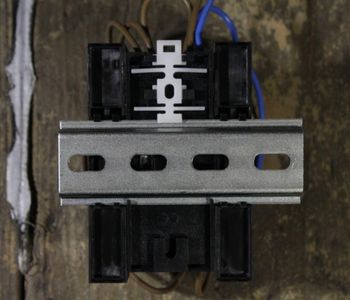

Step 3: Put Modules on a Rail
With the schematic from the previous section in mind, we can now assemble the box. In the first step, we put the timer and the two coupling relays on a DIN rail. If you bought a longer piece, use the metal saw to cut off a 10 cm piece from the rail. The photo shows the rail from bottom with the three modules lined up. (I took this photo after wiring, so ignore the wires for now). When looking from the top, I call the relay to the left of the timer relay A (as it will be controlled from channel A of the timer), and I call the relay to the right of the timer relay B (controlled from channel B of the timer).

If you use the exact components as listed, the connecting points on the timer are labelled as following:
  • 4 / L and 5 / N: AC inputs
  • 2 and 9: the “common” relay inputs of channels A and B, respectively
  • 1 and 10: the “open” relay outputs of channels A and B, respectively. These are the contacts that will be closed (connected to the common input) when the timer is turned ON.
  • 3 and 8: the “closed” relay outputs, i.e. in the opposite connection state to 1 and 10; we don't use them

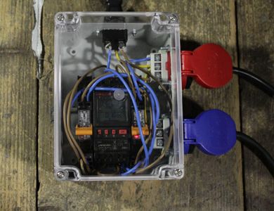

Step 5: Prepare the Enclosure
Now it's time to put the Schuko sockets and the IEC C14 socket in the enclosure. The enclosure on the part list is not cheap, but it pays off here; the walls are 4 or 5 mm thick and made of polycarbonate, which means, it's easy to drill without danger of breaking the box. I don't own a CNC yet, so I created the holes for the sockets by using regular wood drill bits and a manual drill. The Schukos require a circular hole with c. 40mm diameter. I found a 35mm circular drill bit, made initial holes, and then used a manual milling machine (Dremel with a polishing / sanding blurr) to approach the target cutout.
As you can see on the photo, I placed the IEC socket on the short side (top), and the two Schukos on the long side (right). I used M3 screws to fasten the IEC to the enclosure, and I used M4 screws to fasten the Schukos to the enclosure.
The DIN rail with the modules will be placed towards the short side (bottom) opposed to the IEC; you can slide it in to find a good position, and make markings for two holes, where we will put screws to secure the rail from the enclosure's bottom. If those screws bother you, you can add rubber pads to the enclosure's bottom.
Connect the ground points of the IEC to the ground pins of the Schukos, e.g. using a yellow/green wire. The ground points are the middle screw terminals of each socket. Then add blue and brown wires for the Schuko's AC lines. I use 18 cm for the Schuko with the blue cap that will be channel A, and I use 14 cm for the Schuko with the red cap that will be channel B.
Step 6: Install Modules in Enclosure
Finally, slide the rails with the modules into the enclosure, carefully squeezing the cables. Secure the rails with two M3 screws from the enclosure's bottom. Use suitable shims before securing the screws from the inside with nuts from the inside. Yes, everything is a bit crowded in there, you need some plier to hold them, and some patience.
Then connect the blue and brown wires coming from the timer, points N and L, to the IEC socket's outer screw terminals. Remember that there is no guarantee about the polarity, but German Wikipedia says that if you attach the socket so that the ground pin is towards the bottom, then when looking at the socket from the outside, the N connector should be on the right, and the L connector should be on the left. You can see this orientation on the photo.
Then connect the blue and brown wires coming from the Schuko with the blue cap to relay A, points 14 and 24; and connect the blue and brown wires coming from the Schuko with the red cap to relay B, points 14 and 24.
