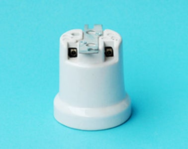

Take the plumbing fixture that you picked to be the end of your lamp (the one that the bulb will be in) and find a standard light bulb fixture that will fit inside of it. Using bell reducers to get up to a large diameter at this point looks really cool. The bulb socket that I ended up buying was surrounded in ceramic, and it would have actually fit a lot more snugly to a 1 1/4" end piece. Regardless, just be sure that the socket will fit inside of the end piece.

Affix the light bulb socket to the inside of your end-piece bell reducer. I used hot glue from the back end so that it wouldn't be visible from the front, but you could use whatever. JB-weld might be a smart option.

Run the power cord through the body of the lamp and up to the joint where the bulb socket and power cord meet each other. Strip back about an inch of either of the power cord wires. Solder the bulb socket wires and the power cord wires together, then reassemble the lamp.
