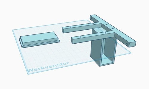

I found a great 3D design for a rain gauge with a tipping bucket.
See https://www.printables.com/model/386114-rain-gauge-pluviometer
I added a holder and a smal box with a cover to mount the Pluvio on my garden fence including the electronic parts for the transmitter. The cover is sealed against the ingress of water with a small rubber band between the cover and the box. I covered the small reed switch with ductape as a protection against water drops.
The bucket is mounted on a metal rod and uses a small round magnet to activate the reed switch.

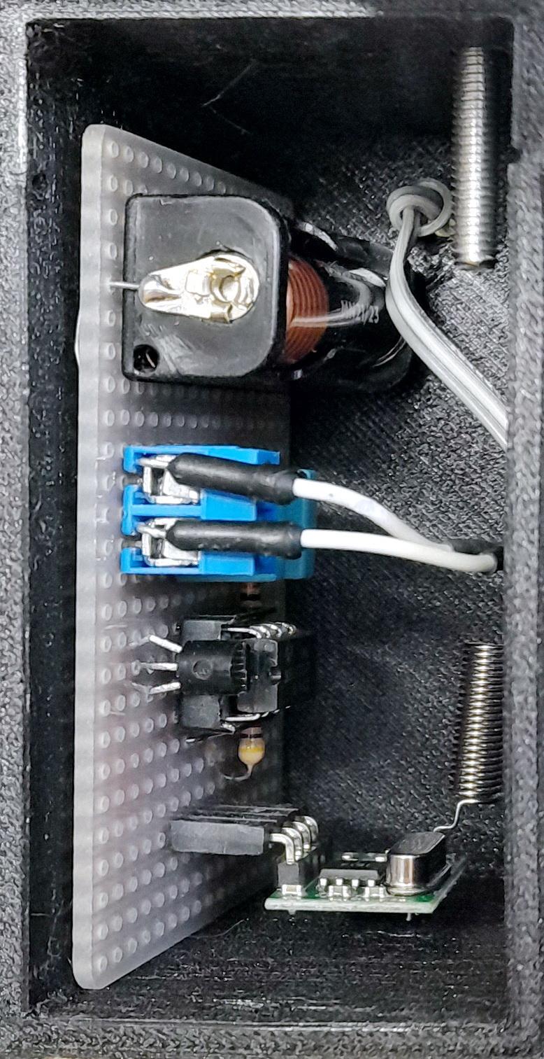

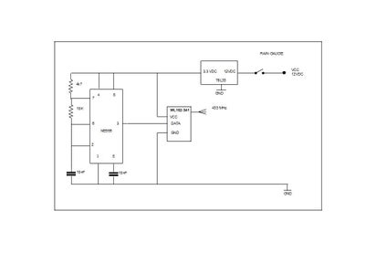

Step 2: The 433 MHz Transmitter
The transmitter uses a WL102 433MHz RF Wireless Module to send a signal to the receiver.
433MHz is a commonly used frequency band for all types of equipment that require little power, such as garage door openers, headphones, baby phones and remote controls. Also many inexpensive transmitters and receivers for switching devices and light dimmers operate on the 433MHz band.
When experimenting with the 433 MHz wireless signals for my Pluvio I found that there is a lot of interference and noise in this area. During testing I connected a small audio amplifier and I heard a lot of beeps, cracks and hissing on this frequency band. The temperature meter from my neighbour transmitted a signal every 30 seconds.. I did not want to receive this wrong information so I used a clean pulstrain of 6kHz generated with an NE555 chip, connected to the transmitter. This signal is filtered out of the noises with the software in the receiver. It works really well, the receiver did not react on the disturbances at all.. The transmitter is switched on together with the NE555 oscillator via the reedswitch. This happens only a short time when the bucked tips. When the bucked is not activated both are completely switched off so there is no constant power needed from the battery.
The specification for the minimum voltage of the NE555 is 4.5 Volt. But my Pluvio NE555 works fine with 3.3 Volt.

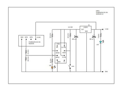

Step 3: The 433 MHz Receiver and the WiFi Connection
The receiver uses an RX470 433Mhz RF Wireless Module.
The output is connected to the input of the ESP01 via a voltage divider with two resistors. This is done because the receiver voltage level is 5V and the ESP01 needs 3.3 Volt on the input pin. The PCB has a connection for 5 Volt power supply (connected to a standard USB charger). Plug the cable into the charger and cut the plug on the other end to connect the red and black wire to the screw block for the power supply. The receiver is connected to this voltage and the ESP01 is connected via a 3.3 V voltage regulator. A red led shows the presence of power, a blue led lights up when a 6kHz signal is received. The receiver and the ESP01 are both mounted on a socket for easy exchange if something goes wrong.
Reset of the ESP01 is done with a tactile switch on the PCB.

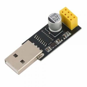

In this instructable you can also read how to use the CH340 3.3V TTL USB Serial Port Adapter to connect the ESP01 to the USB port of your computer. This adapter needs to have an additional reset button for easy programming, the mounting of this extra button is also described.

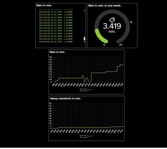

To make the rain data available on the internet you can use a free account from Adafruit IO. You will get a user name and you will get a special IO key code to get access to your data. Keep this info in a safe place.
To use the IDE with Adafruit IO you also need the Adafruit IO library. You can install this library in the IDE library manager or download it here: https://github.com/adafruit/Adafruit_IO_Arduino

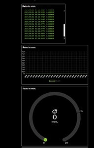

On the Adafruit IO website you must make a "feed" definition and you can also make a dashboard with a table and/or a graphical presentation of yor rain data. 10 feeds and 5 dashboards are included in a free account.
This information can also made visible for others without exposing your account information.
See here for all details: https://io.adafruit.com/

Step 6: RAIN!
