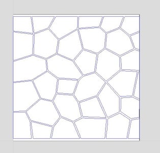

Step 1: Plan Your Design
  1. Measure the width and height of the wall you would like to use for this build.
  2. Make a sketch of your wall outline and add in any shapes you would like to incorporate onto the new wall. I chose some random geometric shapes.

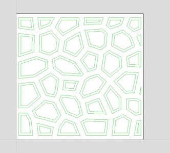

Step 2: Create Your Final Design
  1. I used Vectric Aspire to create the final design on my computer, however, this is not required. You could easily use pencil and paper or even draw directly onto the wall.
  2. Once you have your final shapes drawn out, decide the spacing you will use in between them. The spaces between the geometric shapes in my design are 1/2". You can make them larger or smaller but 1/2" seems to work pretty well.

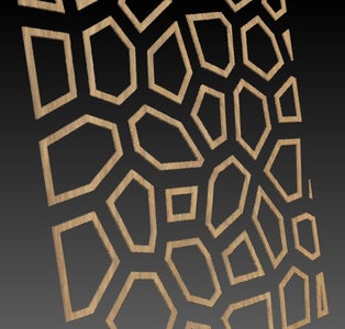

  3. In order to have space to install the LED strips, this wall consists of two layers.
  4. The inner layer (the layer against the drywall) is 1/2" thick.
  5. This layers' pieces are the same shape as the outer layer, however, they are offset so they are 2" smaller. Also, these pieces have the centers removed to allow access through the drywall for the LED wires.
  6. The outer layer (this is the visible layer once complete) is 3/8" thick.
  7. This is the layer that has a 1/2" gap between the pieces.
