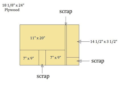

Step 3: Plywood Cuts Overview

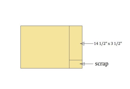

In the next few steps you will be cutting the plywood as pictured above. steps 4-7 can be skipped if you simply cut this layout.
Step 4: Cut a 3 1/2" X 14 1/2" Strip
-Set your rip fence to 3 1/2" and cut a strip of plywood 3 1/2" x 18 1/8"
- Using your miter gauge cut the same piece down to 14 1/2" long
- Discard the scrap

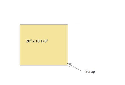

Step 5: Resize Remaining Plywood
Resize your plywood to be 18 1/8" x 20"
Step 6: Cut Your Plywood in Two
- Set your rip fence to 11"
- cut your plywood into two pieces
- 11" x 20"
- 7" x 20"
Step 7: Cut Two Legs 7" X 9"
Cut the 7" x 20" plywood into two 7" x 9" legs and discard the scrap.

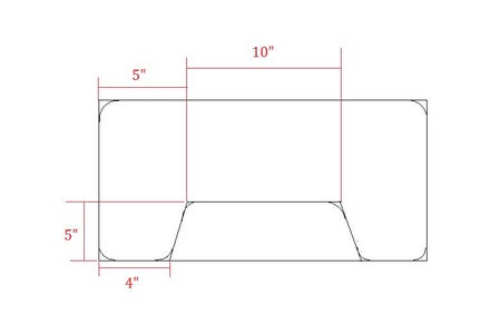

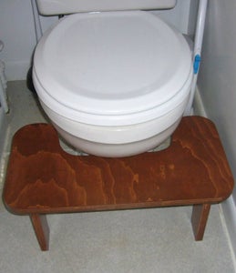

Step 9: Shape the Top
I have included the dimensions I used to shape the top, however, since each toilet is different I suggest tailoring the shape to your needs. I used the same cup from the previous step as a stencil to round all corners.

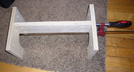

Step 11: Drill Pocket Holes
Drill three pocket holes at the top of each leg and two pocket holes on each end of the support brace.

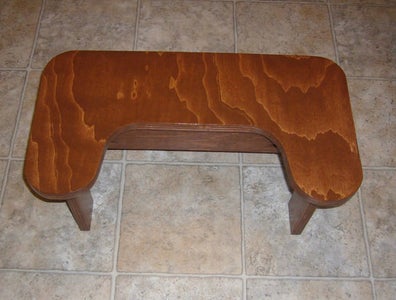

Step 12: Assemble!
I will let the pictures do the talking for assembly. I used 10 pocket screws and wood glue. I had intended to center the cross support, however, I failed to plan ahead when drilling my pocket holes and ended up offsetting the center support. The offset does not seem to make any difference in overall quality.

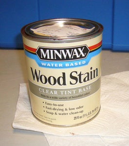

Step 13: Stain the Potty Pedestal
I stained this ible using Minwax water based tintable stain tinted to Rosewood. There are many people better suited to give advise on staining, however, I will say that this stain was very easy to use and very low odor. Two coats of stain will give you more even coverage, however, I was happy with the look after one coat so that is where I left it.

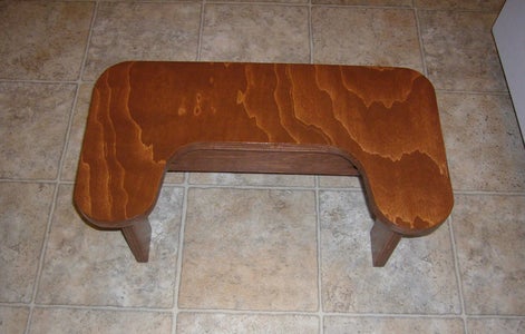

Step 15: Conclusion Indeterminate
Does squatting relieve pressure and expedite the poopin' process? Well, I have no idea... I enjoyed the challenge of building this 'ible and I learned a-lot along the way, but like most 'ibles this was more about the joy of making than anything else.
