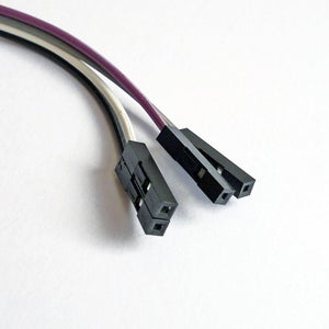

Fan screwed into place, signal wire (white) cut off and red and black wires left. Since my Dupont single pins didn't arrive yet I used the existing ones that were on the fan and piece of heat shrink to make them into small clamps. I highly recommend not doing it this way and buying the proper pin-to-pin connectors.
Other thing I did was that I cut off a layer of plywood where the USB and RJ45 are so that my fan would lie flat with the top. Wouldn't have to do that if I opted for the sides to be 50 mm high instead of 45 mm.

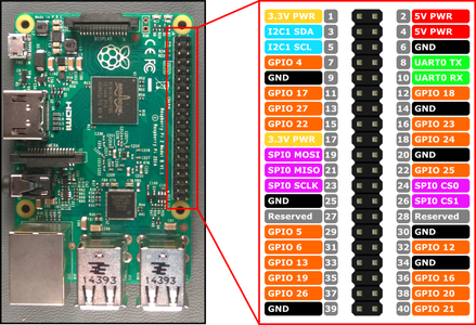

Last I connected the fan to the Pi. As seen on the GPIO pinout, red is connected to 5v (pin 4) and black to ground (pin 6).
Assembled the enclosure and checked if everything works before painting.
