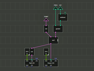

Indicating the state.
LEDs are never enough =). The gun has two LEDs: the green one and the red one. If the compressor is not switched on and the pressure in the system (PRES) is equal to the estimated (EST) or slightly less than it, then the green led lights up (Pic. 6). It means that you can safely press the trigger. If the pump is running or the system pressure is lower than that which you have set on the screen, then the red led lights up, and the green goes down.
