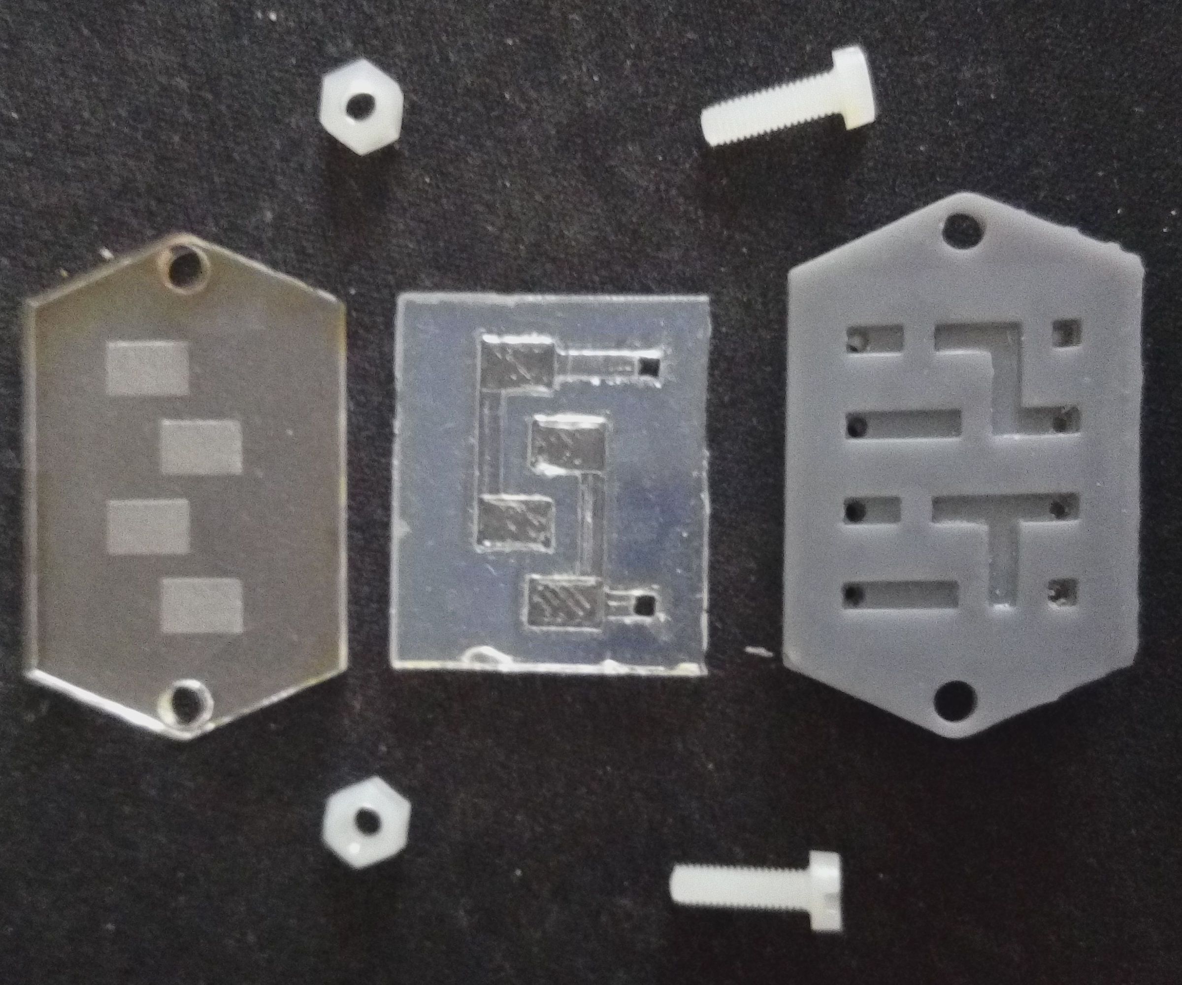

Step 3: Cutting Silicone
Sharpen the ball needle with a drill bit.
Cut 4 pieces of 1mm thick silicone sheet 28 by 24mm, and 1 peice of the membrane with the same size
Following the design on the square grid, push the sharpened ball needle into the silicone to cut holes and corners and then join the holes with a craft knife. The neater the cuts are, the easier it will be to align the layers.
Mark a corner of each layer with a pen. This will make it easier to arrange layers later
I also tried laser cutting the peices. The silicone cuts alright, but the peices wont stick together anymore, preventing an airtight seal.
In the future, I will use a 3d printable mold to cast the silicone peices, as this is the most tedious part of the project. I have included the STL files if anybody wants to try it.
Step 4: Case
Cut 2 pieces of acrylic 28mm by 24mm (can be made wider, e.g. 40 by 24, to allow the 2 pieces can be screwed together)
Cut 8x 8mm lengths of 3mm diamiter rigid tubing
Drill 8, 2.8mm diamiter holes in 1 peice of the acrylic. The centers of the holes should align with the end of the channels in the first silicone layer.
Use the 90deg countersink tool to deburr both sides of the hole to make sure they are completely flat and that the silicone sheet adheres around each hole without creating air bubbles.
Firmly push a peice of tubing into each hole, making sure that it dosnt come out easily. If it starts poking through to the other side, use a craft knife to bring it in line with the surface. Any bumps on the surface will cause the silicone to not adhere as well..
Step 5: Assembly
Clean every component with water and dry it to make sure there is no dust or hair stuck to the surfaces.
Now stack the layers one by one, starting with the outside and ending with membrane in the center:
Press layers 1 & 2 against the acrylic peice with tubes attached, making sure no air bubbles are left between the layers.
Flip layers 3 & 4 & the membrane and press them against the acrylic peice with no holes.
Press the 2 sides together now.
Looking down through the top of the chip, it should look like the mirror image of the original design (it dosnt matter if its not, just that all the marked corner of each layer are in the same place)
