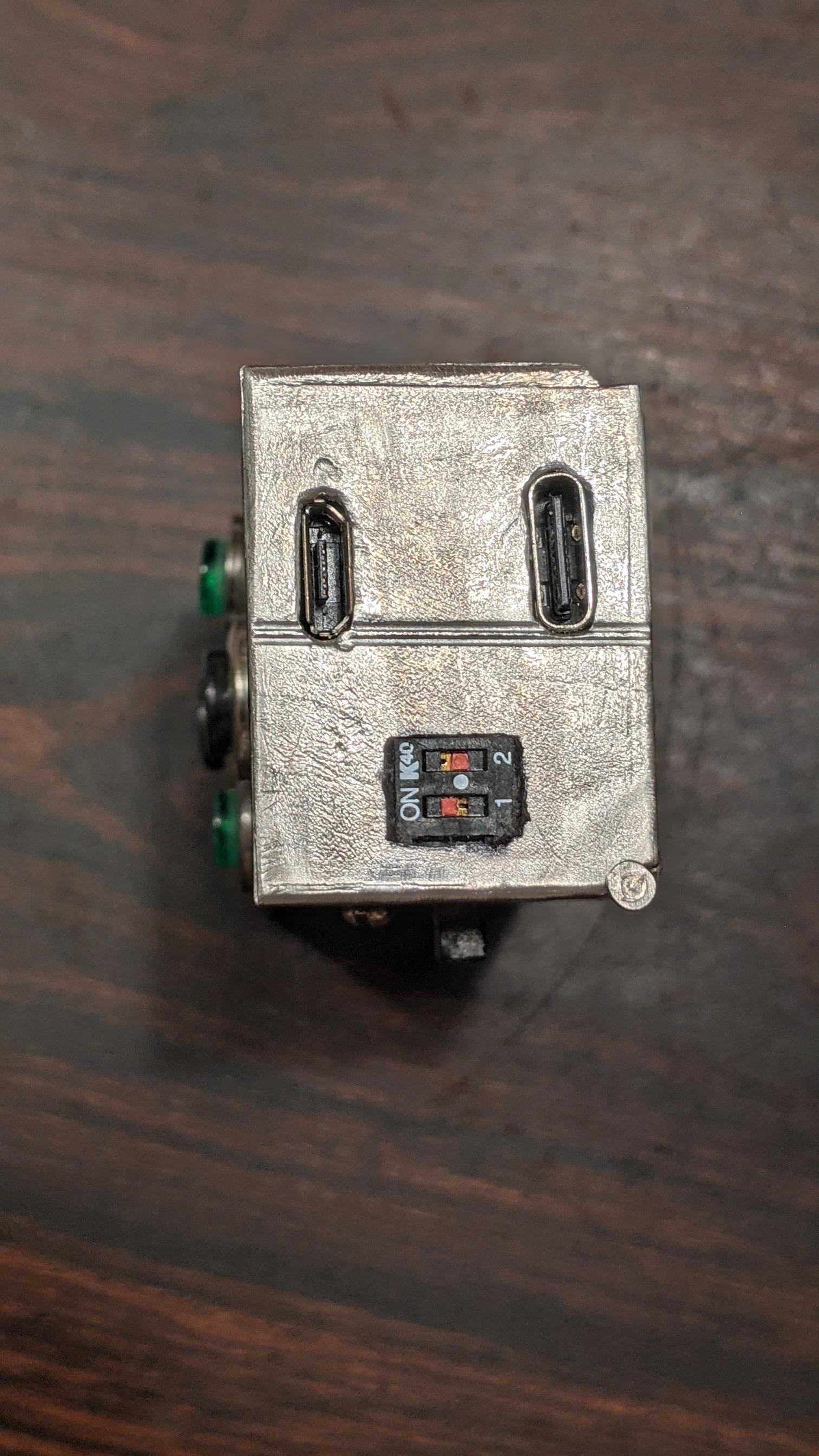

Fortunately, I happened to have a very small switch (technically two single throw, single pole DIP switches) in my parts box. Moreover if I place it just so, flush to the endcap, it makes a cute little robot face!
Though I have no need for it, I was able to wire a second pin to the second switch as well as the one for the speaker. If I ever want to add another feature, I have a wired line controlled by a mechanical on-off switch ready to go. It's nice when one can leave the possibility of upgrading open.
Being flush with the endcap face, the DIP switches require a small, hard point to change positions. I use a nail which fits neatly in a groove in the bottom of the case. The nail is held by a piece of adhesive tape which also holds a flat piece of aluminium in place over the access trench on the bottom. Tape is not the most elegant solution; this is definitely an area for future improvement.
