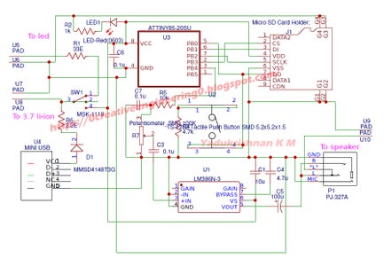

Step 1: Circuit Diagram & PCB Design
The circuit diagram is given above. The brain of the circuit is the ATtiny85 micro-controller. It read the data from the memory card and decode it to the analog signal. The output weak signal is amplified by using the low voltage amplifier IC LM386. It drives the two speakers(connected in parallel). the speakers are obtained from the old mobile phones. The battery here used is the Li-ion cell. It charges by using the USB nano port. The emergency light LED is 3 small SMD LEDs. It is obtained from the mobile phone LCD back-light. The ON/OFF switch is an SMD slide switch. Which has 3 positions ON/OFF/ON. There is an SMD push switch. It is used to move to the next song.
For more details about the circuit, please visit my BLOG,
https://0creativeengineering0.blogspot.com/2019/06/diy-portable-pocket-music-player-using.html

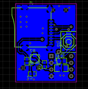

The PCB design is done in the Easy EDA software. It is a double sided PCB. It is made by using the two single sided PCB glued together. The PCB design and the Gerber file are given here.
Step 2: PCB Layout & PCB Cutting
First we print the PCB layout into a glossy paper (photo paper). In the printing time the 2 sides are print separately and take mirror image of the front side and non-mirror image of the rear side.Then cut the two layouts from the paper. Then mark the same dimension of the layout into the copper clad and cut the 2 pieces from it by using hacksaw blade. Then clean its rough edges to a smooth one by using the sandpaper or file. Then clean the copper side using sandpaper. We successfully done this step.

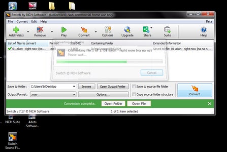

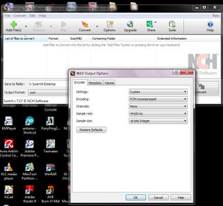

Step 19: Music Format Conversion
The music player only support the wave files. It is an uncompressed file format. The widely available music formats is mp3. So it is necessary that to convert it into the wave format. For this process I use an application named "Switch Sound File Converter" from NCH software family. I use this software, this is very good for the conversion. The essential setting for the conversion is given in the above images. Please observe and follow the settings. Then write the wave music into the SD card. Then insert it into the music player and enjoy.
