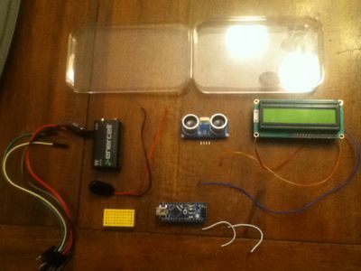

Parts:
Arduino Nano or smaller
9V battery
4-pin ultrasonic sensor
Parallax 2x16 (or other) LCD screen
Wires, jumper wires
Push-to-break (normally closed) button switch
Very small breadboard
9V battery plug
Zip tie (or something similar; basically something long and thin)
Motor terminal connector (or something similar; basically something small and short)
Pocket-sized container - I used an iPod touch 4 case; if you use an iPod 5 case the components will probably fit inside better
Tape

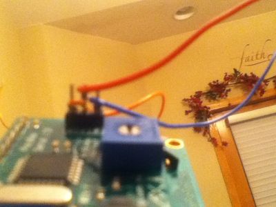

For this project I used an iPod touch 4 case that they're sold in, and since the Parallax LCD screen is less than a millimeter too high, I connected the wires as shown in the picture. By wrapping the wires tightly around the pins and spacing them out with the insulated wire you can plug it in to the breadboard (and fit it inside the iPod case) without using jumper wires.

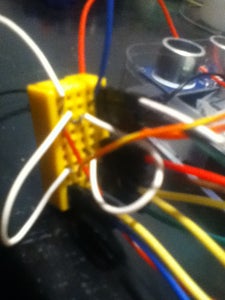

Step 2: Wiring the Circuits
Assemble the circuit in the diagram (but with a 9 volt battery instead of 2 AAs [this was my first time making something with Fritzing!]). Also, in order to make the device power up when opened, you need to use a normally-closed switch.
As far as the breadboard goes, I got mine from an electronics kit. It 10x5 plugs and is smaller than the Arduino Nano. If you're going to be using an iPod case, I'd recommend either using one very similar in size or none at all. If you manage to find one like this and you're using jumper wires, try to put as many of them on one side as possible, to save space.

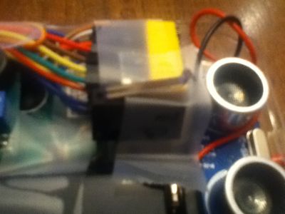

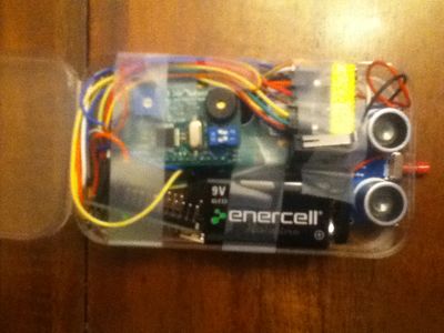

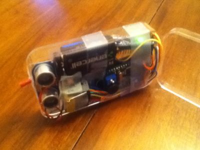

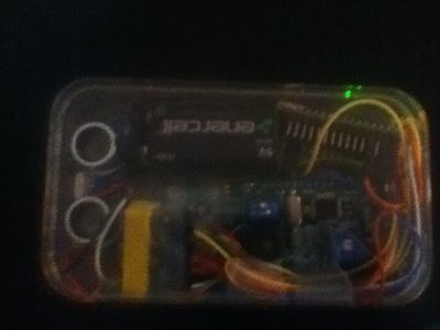

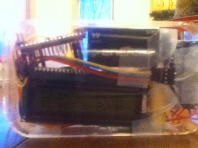

Step 4: Fit It All Inside
After a few hours of experimenting the setup below is theonly wayI could find to fit everything inside the iPod 4 case. As I said earlier, if you use a bigger case, even an iPod 5 case, the layout could be different. Or, if you find another way that works, great! In this case, though, there are several things to take into consideration:
The LCD screen should be one of the first things in - keep it as far towards the back (the hinged side) as possible while still leaving room for wires.
Place the ultrasonic sensor at the front of the case with the jumper wires running to the back of the case.
If you use a small breadboard, put it in last so you can get to the wires before and after assembly.
Place the switch on top of the other components so that it is depressed when the cover is closed.
Secure all the components with electrical/duct/clear tape when putting them in, then with additional bands over the top to secure wires and loose parts. You may not want to secure the battery as much if you're going to use it often.

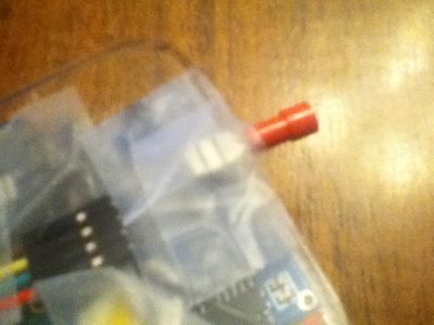

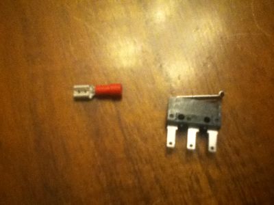

Step 5: Construct a Latch
This is a simple homemade latch you can use to keep the case closed. If you have a better one I'd recommend using that instead, but if you don't then this works well enough. Basically you just tape the small object you chose (like a motor terminal connector) to the top or bottom and then tape the longer thin object (like a zip tie) in a loop to the other side in such a way that you can press down on the case to pull the loop off the "hook" - you want the case to be slightly open by default.
Also, my iPod case still had some tape from when I got it that worked well for a hinge, but you can add tape or another type of hinge too.
