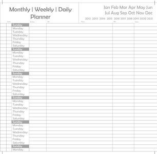

Step 10: Monthly View
Monthly view. An entire month on one page.
Step 11: Weekly View
Weekly view, weeks are separated by bolded "Sundays"
Step 12: Daily View
Daily view with a place for all day, am, noon, pm events and notes.
Step 13: Enter Month and Year
Circle or highlight the month and year and inset the days of the month and the year. I've designed this so no matter when the first day of the month occurs, you can use the same layout. I've also planned this out for a 10 year use.

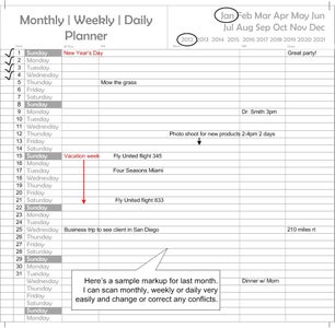

Step 15: Sample Markup
Sample markup. Here's a sample of how you might mark up events.
