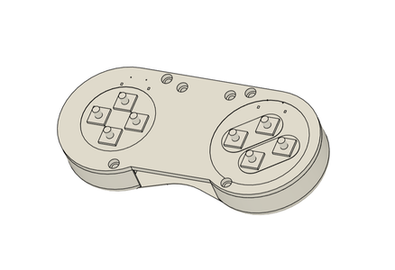

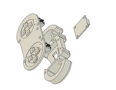

Step 1: DESIGN
We begin by creating the project's model, which was a major challenge.
We created an XL version before developing the Tiny version. The XL version has an unrestricted area, allowing for unrestricted component layout without regard for space.
In our Tiny version, the initial idea of assembling an enclosure and placing components inside proved impractical. Instead, I designed a PCB that accommodates all components on both sides, with a frame-like part attached to the bottom. This frame provides protection for the adapter board and improves user grip.
The SMD buttons are positioned on the top side of the PCB, while the right-angle tactile switch and the RP2040 Tiny Dev board are placed on the bottom. The USB adapter board is mounted on the back, secured by screw bosses integrated into the frame.
Once the model was finalized, we exported the mesh file for 3D printing using transparent PLA, allowing the onboard RGB LED to illuminate through the material. Additionally, the board’s DWG file was exported for use in the PCB editing process.

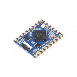

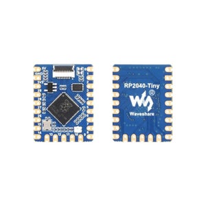

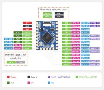

Step 2: RP2040-Tiny Micro Development Board
We are using the RP2040-Tiny mini development board, which is based on Raspberry Pi's RP2040 core. It includes a separate programming adapter board that keeps the type C USB port separate from the circuit, reducing overall thickness and size, making it easier for users to integrate into their projects.
In terms of technical specifications, it's essentially a Pico with an RP2040 microcontroller chip and a few modifications, such as the Onboard FPC 8PIN connector, which connects the module to the Type C adapter board, and the addition of Castellated holes or pads, which allow soldering directly to carrier boards.
We also have a WS2812B 2020 Package LED added on the board, which is connected to GPIO16.
Overall, this board shares its technical parameters with PICO 1, which includes the RP2040 Dual-core Arm Cortex M0+ processor, flexible clock running up to 133 MHz, 264KB of SRAM, and 2MB of onboard Flash memory.
For in-depth details about this Dev Board, you can check out its Wiki Page from the link below.

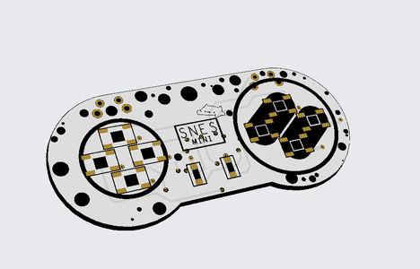

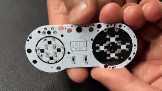

Step 3: PCB DESIGN
As previously stated, the PCB design for the Game Controller was truly simple; it is essentially an RP2040 Tiny Dev Board connected to 12 SMD Push buttons, each of which is attached to an RP2040 GPIO Pin. All SMD Button Terminals are linked to GND. When a button is pressed, the GPIO attached to it is connected to GND, and our microcontroller registers the change in button state.
After setting up the schematic, we exported the netlist and used the DWG file from the 3D model to create the shape of the board. All SMD buttons, including the two trigger buttons, were placed according to the 3D model. Four mounting holes were also added to the PCB, which will be used to connect the frame to the board.
The RP2040 Dev board is put on the bottom side of the board.

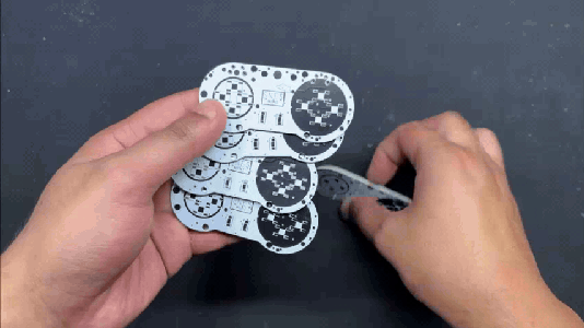

Step 4: PCBWAY SERVICE
Following the completion of the board design, we ordered a white solder mask with black silkscreen and submitted the PCB's Gerber data on the PCBWAY quote page.
PCBs were received within a week, and the PCB quality was outstanding. Here, we added a few design elements on the board's silkscreen layer to increase the aesthetic appeal of the project. PCBWAY made the custom layer properly, which shows their great PCB manufacturing capabilities.

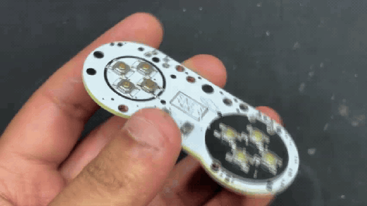

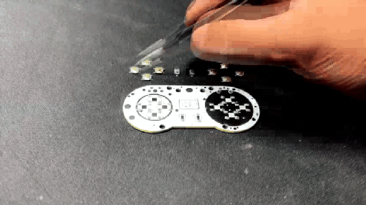

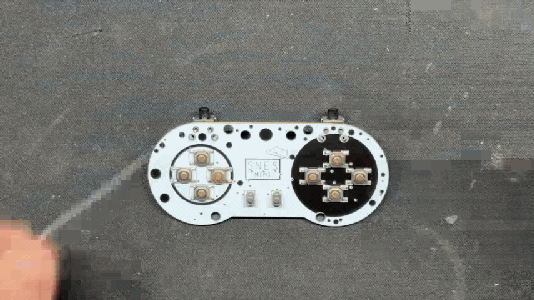

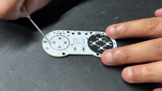

Step 5: PCB ASSEMBLY-SMD SWITCH ASSEMBLY
  1. We begin the PCB Assembly process by placing SMD switches on the top layer of the PCB. This is carried out by applying solder paste to each component pad one by one with a solder paste dispensing needle, in this case using normal Sn/PB 63/37 Solder paste.
  2. We use an ESD Tweezer to pick and install all SMD tactile switches.

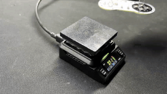

  3. We next pick up the circuit and place it on our Miniware Reflow hotplate, which heats the PCB from below up to the solder paste melting temperature, allowing us to solder all of the components in their proper locations.

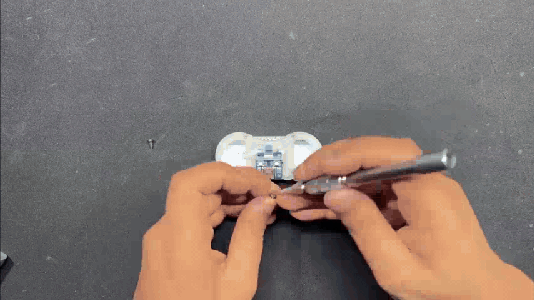

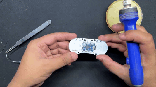

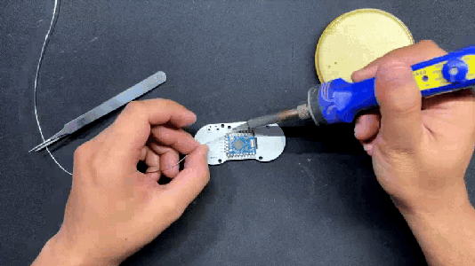

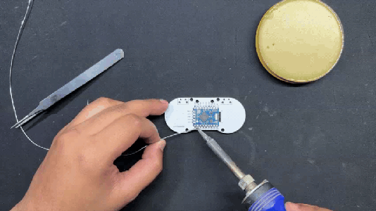

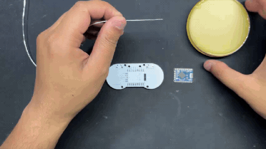

Step 6: PCB ASSEMBLY—RP2040 Tiny Assembly
The RP2040 Tiny Assembly process differs slightly from the previous reflow process in that we cannot use a hotplate to heat the surface of the PCB since it contains SMD components on the top side, preventing us from using a hotplate to solder components on the bottom.
  1. We use our soldering iron here; first, we dip the solder wire in flux before melting it on the first pad on the RP2040 tiny's footprint.

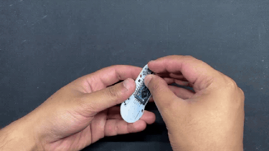

  2. We use tweezers to pick and place the RP2040 in its location, then use a soldering iron to heat up the previously soldered pad. This will melt the solder and attach the RP2040 to its footprint.
  3. We then solder the opposing terminals of the RP2040 Tiny, securing the module with its PCB Footprint. All that remains is to solder all pads with a soldering iron.

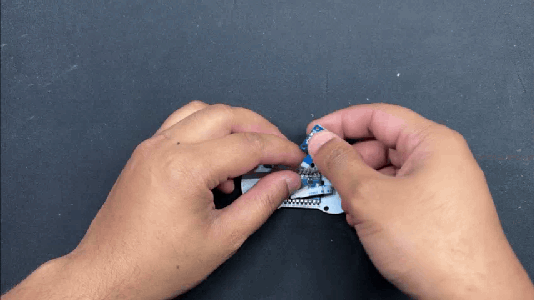

  1. We install the THT switches from the bottom side of the circuit.
  2. next we solder their pads from the top side of the board with a soldering iron.
  3. Finally, we use a wire cutter to trim the THT Vertical Switch Pads that are visible from the top side.

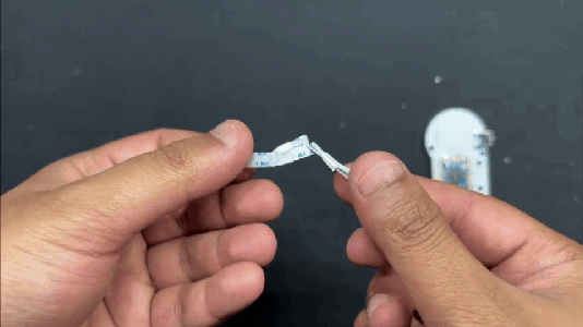

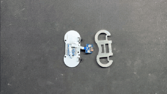

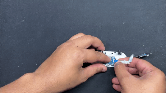

Step 8: Adapter Board & Controller Connection
Now that the board assembly is complete, we begin the assembly process of connecting the USB Adapter Board to our Main Switch Board. For this link, we utilize the provided Flexible cable, which we first attach to the Type C board.
Next, we connected the flex cable to the connector found on the RP2040 Tiny board. The connection order of the flex cable is crucial; the blue side should likewise be on the top side, and the cable should be routed all the way through the inner connector.
Also, the cable that came with the RP2040 was rather long, so we bent it to make it shorter.

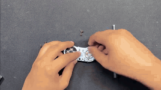

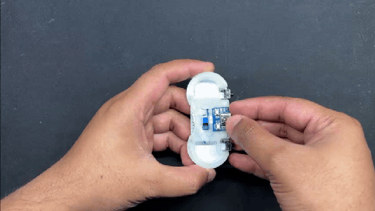

Step 9: FRAME ASSEMBLY
  1. The frame assembly process begins with passing the USB Adapter board through the Frame part, followed by aligning the circuit's mounting holes with the Frame part's.
  2. We then use four M2 screws to secure the frame part to the circuit.
  3. Next, place the adaptor board over the screw bosses added to the back side of the frame and fasten it in place with two M2 screws.

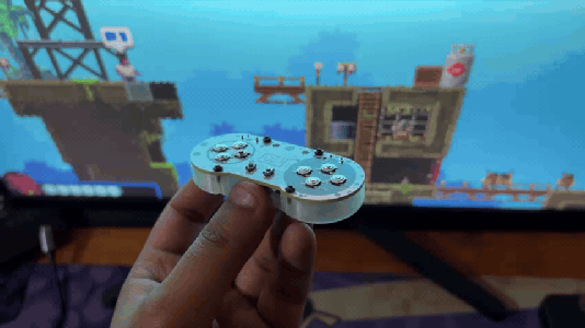

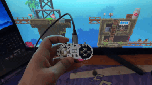

Step 11: RESULT

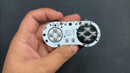

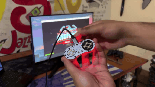

Here's the end result of this simple and tiny build: the Pocket SNES game Controller, an extremely portable gaming controller designed for playing old retro games with a layout similar to the SNES. It can also be used to run select modern titles that don't require left and right thumbsticks.
This device has dimensions of 74.5mm x 33.8mm x 11.5mm, making it one of the tiniest DIY game controllers.

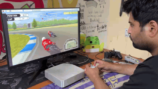

For testing, we first played Broforce, an action-packed, side-scrolling run 'n' gun game with a campaign, bonus levels, unlocked characters, and violent enemy clashes. Broforce is a group of hyper-masculine action heroes inspired by renowned characters from old movies and TV shows. They fight terrorists and free their fellow Brothers from captivity. Each Bro has distinct talents, weaponry, and special attacks, making them handy in a variety of circumstances. This game is pretty awesome and fun to play in multiplayer.
The controller is an ideal match for a side-scrolling game; the controls were first mapped in the game settings, allowing us to manage our player.

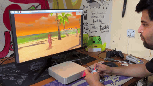

We installed Broforce on Windows, but what if we want to utilize this controller on another operating system, such as Raspberry Pi or another game emulation OS? Testing was critical since it would allow us to use this controller with our past Raspberry Pi-based game console projects.
Using our previous build MAC Pi, we installed the PPSSPP emulator using Pi applications and then played a few PSP games, including Dead or Alive Paradise and Moto GP 3. We first had to map the button in the settings, and then both games ran quite smoothly with our Mini Controller.
The Small SMD Buttons were not particularly soft to use, but they functioned properly overall.
