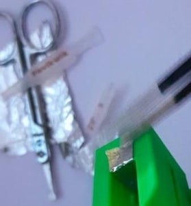

  • I had this old laser pointer. The lens inside has good power, small focal length(around 5mm) and has aberration rectification.
  • To get the lenses, unscrew the back of the laser, and pull the black sponge out by tweezer.
  • Unscrew the laser shell by a divider or any sharp two pronged tool. be careful not to damage the lens.
  • We need two such lenses.

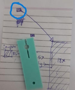

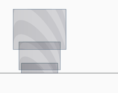

Step 4: Calculation for a Compound Microscope
See the image above for reference. The website link is also shown in the picture for reference of the thory.
Theory:
  • The focal length of the eyepiece 5mm.
  • The focal length of the objective is 5mm
  • If we provide d0, the object distance at 6 mm from the objective, first image will be at di=1/(1/5-1/6)=30mm
  • if di'=15cm or 150mm, then d0'=1/(1/5-1/150)=5.172mm
  • Total magnification= (di/d0)*(di'/d0')=145x

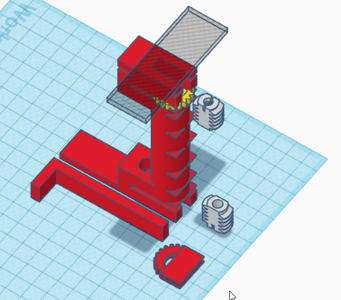

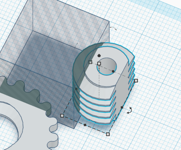

I was not sure how the device will turn up. But I started making the project in Tinkercad step by step and see where it goes. Tinkercad was good for this project.
My first idea was that it should be: A. 3D printed , B. Fine adjustment possible C. Attached nicely to mobile. D. stabilty of output view.

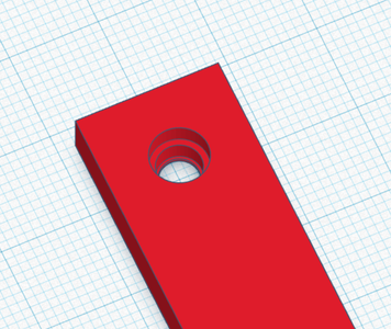

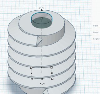

  • To have fine adjustment, we need a screw mechanism. If we keep pitch of 3 mm suitable for 3D print, we can have 3mm/360 degree. So, the adjustment ration is 8.3 micrometer per degree or turn.

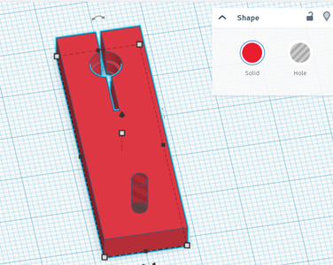

  • Then we make a hole for the Lens.
  • Gear for the adjustment: We place a gear which we can rotate. we make a threaded hole inside it. the hole has to be bigger the the thread of the lens holder. I had to make few adjustments on the clearance to get it right.
Step 6: Guide

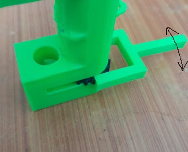

  • Add two boxes and cut the sides of the thread to provide guides.
  • Now we have a device where if you turn the gear, the green thread will move along the axis.
  • Then provide a slit in the thread so that we can place and remove lens easily.
  • Copy the item and change the lens cut sizes.

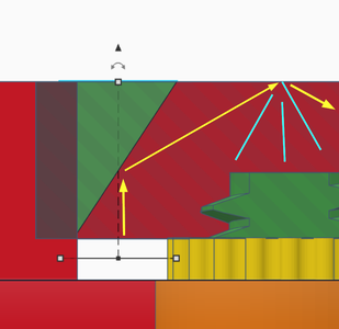

Step 7: Illumination of the Objective by Camera Flash

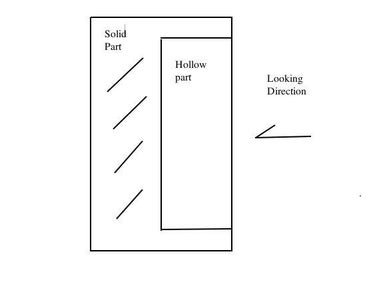

  • I want to use the mobile flash to make the specimen really bright. So, I made a hole for an aluminium pipe. The pipe's reflective inner surface will guide the flash of the mobile to the specimen.
  • Then I made a slope to reflect the light to objective. An aluminium foil will be used glued in the ramp to reflect the light.
  • It shall be reflected in such a way that the object will be illuminated as shown in the picture.

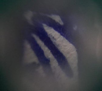

Step 8: Trial 1:BAD Results. Wrong Lens Orientation
  • Needs improvement: The first video recorded in the phone is shown. There are some obvious issues. The image was not clear, the centering was very difficult. The setup of this test required a lot of sanding and fitting effort. The mechanisms were also not smooth because the printer printed the holes 0.4-0.6mm smaller. I gave up on this project for few days at this point.
  • Still, a single line of pen ink is appearing very wide and spread out. So the magnification was much more than a single lens magnification. So the theory is at least right. I felt to return to this project again with new ideas and trials.

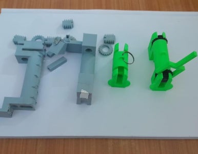

Step 10: Trial 3-Final

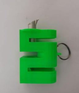

  • A much refined model was 3d printed in trial 3. Mainly a shorter and more manageable length of the scope. It was successful. The making images of the final model are attached.
  • The 3d files are attached also for 3d printing.

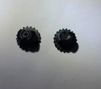

  • The lens near the specimen was attached by the plastic screw taken out from the laser pointer as shown in the 2nd image(left gear).
  • The lens near the eyes needs to be large enough. So the plastic screw was not used. a heated knife was used to heat the PLA and make a notch to hold the lens 2nd image(right).
  • Then attach the aluminium foil and aluminium tube with super glue.

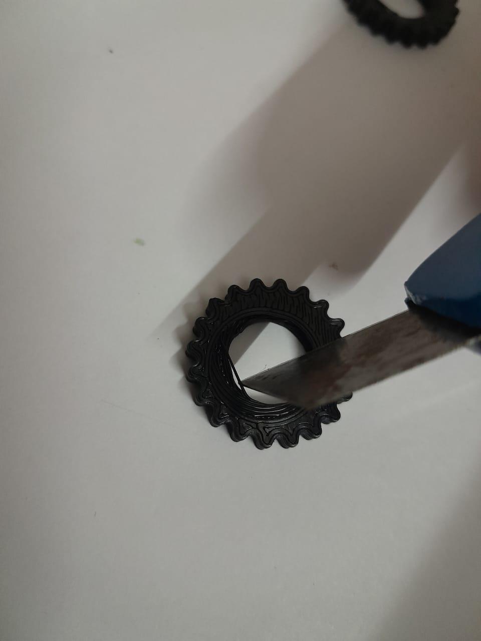

  • The gear top thread may have few threads hanging due to horizontal 3d printing. So it needs to be cut and smoothened with a hot knife as shown. Check till the Gear rotates freely around the threads but not so loose that it moves axially. Then you will not be able to focus easily. (If you print the gear vertically then this problem will be resolved. But another problem will arise of not rotating freely around the threads. Its because of high friction by the layer end protrusions. So its better to have a smooth gear instead.)
  • Tip: If you use heat of 60-80 degrees by a Gas lighter then PLA becomes soft to work and be adjusted. I hope you don't need to do it because I have finalized the right geometry after few trial runs.
  • Anyways, then add the gear and threaded lens holder and we are ready!

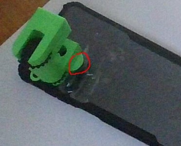

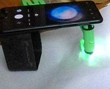

  • For a fixed microscope and easier handling, tape the "Ears" of the microscope to the mobile as shown.

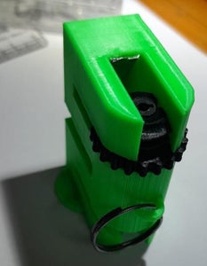

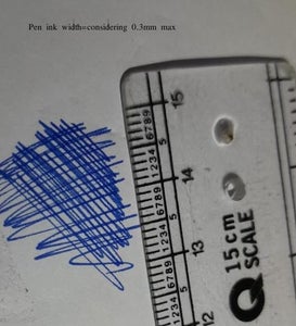

Step 11: Final Results
  • Rotate the bottom gear for focusing. It should be near 5-6mm away from the specimen below. The top gear is only for fine adjustments. You may not need it at all unless you want a really fine image.
  • You may need a little bit of practice before you get the hang of it. Do not be frustrated, keep patience.
  • Also in this compound microscope the image is inverted. So if you want to see to the left, you will have to move it right.
  • The lines of pen ink was 40-50mm in the display. So the magnification seemed to be 40/.3 to 50/.3, or between 133x to 166x.
  • It is purely optical zoom and without digital zoom. If the camera is good, then with digital zoom it can provide a lot of magnification.
  • You will get many interesting images when you look at heads and limbs of dead ants, spider, plant leafs, onion peels etc.

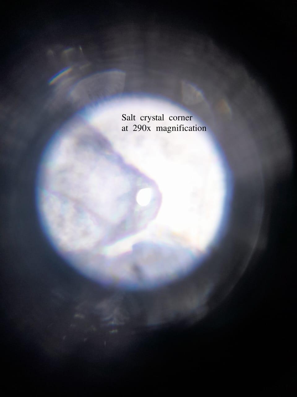

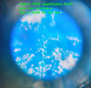

Step 12: Even Higher Magnification

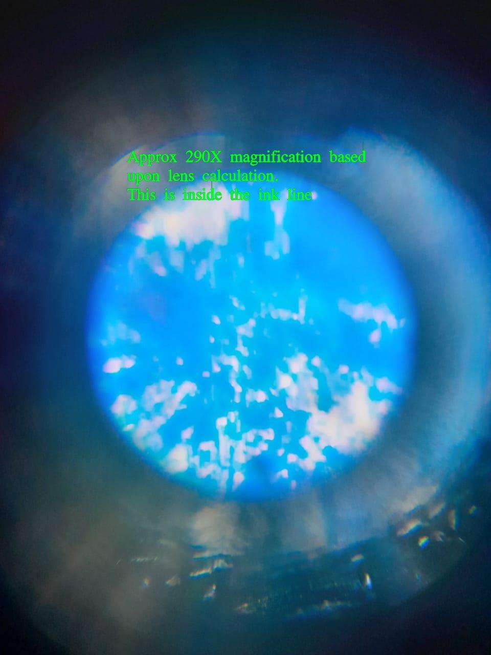

  • A longer tube is designed for higher magnification after we have got the focusing system right.
  • However, we need an external A.C LED source for the lighting at that magnification as shown. For 200-300x magnification, the light intensity also needs to be 200-300 times. The A.C LED light is put under a white paper sheet. Then the specimen slide is put above it.
  • After that, the mobile phone along with the scope is put on a support as shown.
  • As per calculation, it is providing upto 290x magnification but there are minor colour aberrations. So It does not provide a lot of sense to improve it more because it will become illegible I suppose.
