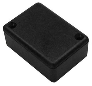

- A Casing: $1.00 - (pick whatever size you want from All Electronics - this is under "Enclosures")

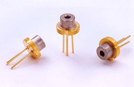

Step 2: Obtaining a Free Laser Diode

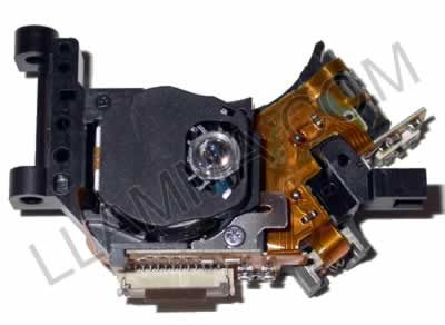

It is actually very simple to obtain a free Laser Diode that could be sold for more than $250! These diodes range from around 100 to 300 mW in power, and emit light at 650-660 nm (red). Please note that this much power can INSTANTLY blind you if you don't know what you are doing. But if you finish reading this Instructable, you will be fine.
So to explain a free diode (without stealing it!), search Google Maps for a local PC Repair Shop. When a tech repairs a computer with a DVD burner and finds that the DVD burner has problems, he/she will usually replace the burner and then throw it out. Many people do not know that DVD burners use laser diodes... to... well... burn! So if you go to a local PC Repair Shop and ask nicely, you can probably get 5 or 6 DVD Burners for free!
But now you must learn how to extract the diode. This step isn't very hard, and is fortunately quite forgiving if you make a mistake.

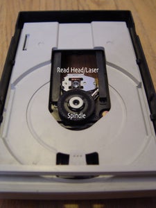

- Open the DVD Burner.
- Pull out the tray
- Remove the laser tray
- Unscrew everything on the tray and cut away anything made of plastic
- See the image below to identify the diode
- Extract the diode and cut the heatsink away.

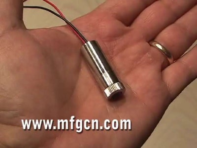

In this step, you will finish the laser module. You are going to have two options. They are:

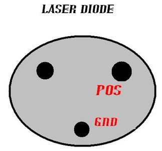

You should see three leads on the diode. Use the diagram below to solder a wire to the ground and positive leads.
Next, unscrew the Aixiz module in the middle. A sticker is covering the seam. Use a hammer and screwdriver to remove the laser diode that is already in place. Once removed, replace it with your new diode. Put the module back together and you are done!
Option 2:
Unscrew the Aixiz module in the middle. A sticker is covering the seam. Use a hammer and screwdriver to remove the laser diode that is already in place. A circuit board will be attached to the diode. Desolder the circuit board and put your new diode exactly where your old one was and solder it in place. Put it back in the Aixiz module and you are done!

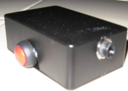

Step 4: Solder It Together
Solder it all together using the schematics below. This is the easy part...
