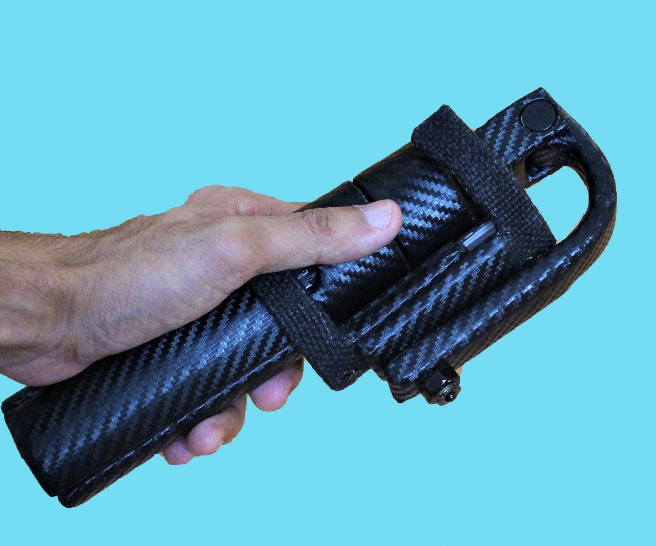

Hello everyone, hope you guys are having fun around DIYs. As you have read the title, this project is about making a pocket vacuum cleaner. It’s portable, convenient and super easy to use. Features like additional blower option, in built nozzle storage and external power supply options takes things to a better level than a normal DIY vacuum cleaner perceptive . The total build process was very interesting and challenging for me since it involved different fields of work like Electronics, cutting and heat molding of PVCs, certain aspects of crafting, upholstery and few others. So, let’s dive into the build! Shall we?
