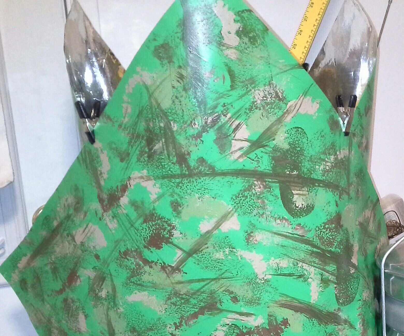

This is a full sized solar cooker that can be disassembled and folded to fit in your back pocket, then reassembled and cooked in.
I used some old poster board squares that had foil on them already. The panels are 14" - 35.36cm squares and the base is 8" - 20.32cm square.
I will show how I finished and folded it.
Here you see it folded in the pocket, ready to assemble and assembled to cook.

Step 3: Finishing the Reflective Panels
1 Tape around the panel to keep the foil from tearing. Then round the corners and punch 1 corner.
2 Use 17 hole template to mark holes. Use awl or punch to make holes.
3 Put the 2 base pieces together with pipe cleaners to form the pockets in a large X. Then use a separate pipe cleaner to hold the punched corners at the center holes.
4 Slide punched corners of panels in base pockets. Line up holes and thread pipe cleaner through all four to hold panels in base.
