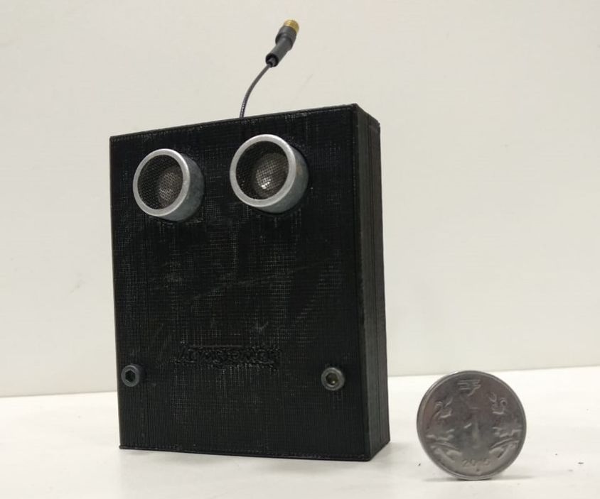

Step 1: Conceal Your Hardware in an Enclosure
Since we are looking to make this circuit look like a pocket-able UPS, we must build its enclosure. Design it on https://www.tinkercad.com/ having required dimensions to house three 18650 cells, battery balancer circuit and a 2.1mm jack. I designed it for 3S 18650 batteries if you want more backup time for different applications you can design it for the bigger pack by changing the z-axis height.
Please note, a plastic container would do the job too!
Step 2: Calculations and Connections
Let's do some math!
3 cells in series would give us an equivalent voltage of 11.1V (3.7V*3)
The total Watt-hour would be = 37.74Wh
Which is enough to run my 12W ADSL router for 188.7mins (37.74Wh/12W)
This is a lot of back-up time to complete your calls and get back to offline activities.
Now connect everything according to the image shown. Here you can observe that each cell's positive terminal is connected to the balancer circuit to have a proper battery balancing while charging and discharging.
Solder the 2.1mm jack to the input(INOUT-). Glue the female 2.1mm jack inside the 3D printed case. Then bring out 2.1mm male jack to connect to the router.
Connect your WiFi router/modem, sit back and relax because power cuts don't matter anymore...
There you go! your pocket UPS is ready!
