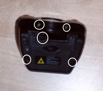

Step 2: Unscrew
Remove the screws from the pocket laser show.
