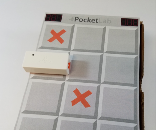

Introduction: PocketLab Temperature Probe Hack
With this simple hack, you can turn your PocketLab temperature sensor into a more traditional temperature probe! This is great for getting quick temperature measurements of any surface. Using a metal screw, you will be making a connection directly from the front of the PocketLab case to the temperature sensor inside it. This will decrease the time that it takes for the PocketLab reach thermal equilibrium with whatever is in contact with the screw.

Step 3: Insert the Probe
We used a small screw (3/16) as our probe, but feel free to experiment! Let us know if you find a better material.
Screw the screw through the hole that you just drilled so that its head is in the inside of the case. Adjust the height of the screw so that its head can touch the temperature sensor while the circuit board is in the case and its tail is exposed through the front of the case. The screw will now be able to quickly conduct heat from outside the PocketLab case straight to the temperature sensor. After this is done, just screw the circuit board and lid back on, and your PocketLab is now ready to be used as a temperature probe!
