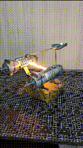

Hello again everyone.. I'm back after a long hiatus with a new/upgrade automata from my X-wing automata i did a few months ago.. i have been getting feedback from you guys to add lights.. and here we are with a new weaving automata of the famous podracing scene from Star Wars Episode I on tatooine..
I've gotten these flexible LED filaments for a while now but i haven't gotten any ideas on what to do with them until i saw a youtuber made a podracer using the same kind of LED filaments.. and i thought it would be a good idea to incorporate it to my weaving automata..
I've also wanted to upgrade the automata to use an internal powerbank that can be charged using USB.. As always, everything was design using Tinkercad and 3D printed..

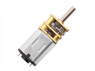

  1. N20 dc motors - 25-50rpm (depend on how fast you want it to weave)

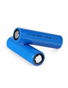

  4. Lithium battery 18650 3.7v

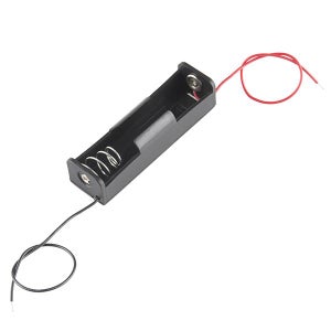

  5. Lithium battery 18650 1 cell holder

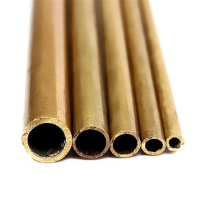

  9. 3mm brass tube - 20cm long x 2

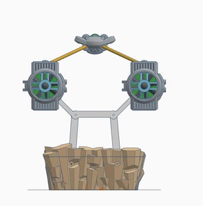

Step 1: Modelled Everything With Tinkercad
The modelling is divided into 3 parts:
  1. Base
  2. Engine
  3. Cockpit
Base
The base was modified from my original X-wing automata with a few upgrades. The new base still uses the same gears and motor except i have split the motor mounting and the holder gear separately. I also extended the original base to fit in a 18650 battery holder. I also added wire holders around the box for easy wire routing.
Since we're doing the podracing from tatooine.. I design the base case with cliff and canyon design to hide the base.
Engine
The engine was design based on a lightsaber.. i use the lightsaber as an inspiration for the engine design and added a few touches to make it look like a podracer engine.. At first i thought the power coupling LED was enough but looking at the engine design.. there was a few places that i could make it glow with the LEDs..
In my original design.. i wanted to add a motor inside the engine to make the fan spins on the front.. the flickering lights would add to the illusion of the engine moving but after i made some calculations.. i didnt have enough power from the powerbank to power 3 motors.. so i had to scrap the motor ideas on the engine.. but the design for the motor mount and fan is still in the engine..
When i brought the flexible LED filament it came in packs of 10pcs so i might as well use them in the engine too.. i modelled an internal light holder that will hold the LED and connect all the wires together..
Cockpit
The cockpit design was slap together using a few beveled boxes and cones in tinkercad.. i did not have any ideas on the design of the cockpit except that i wanted lights in cockpit.. The cockpit and the engine was joined together using a brass tube where i can add wires in the tube for the cockpit led light..
Designing the podracer took a few tries and a lot of iterations since i had to add holes and holders for the LED and wiring..

The first thing we'll need to do is prep and bend the brass tube that will hold the cockpit together.. we'll be using a 20cm long brass rod and put 5cm mark on each end of the tube.. then bend both end at opposite end 45degrees

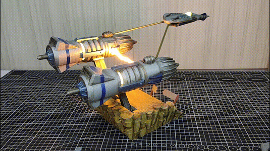

Congratulations.. you have finish assembling the PodRacer Automata..
Step 8: Conclusion
Adding flexible LED filament was a great addition to this automata and made it look so cool.. but learning to make the wiring assembly was a freakin challange..
