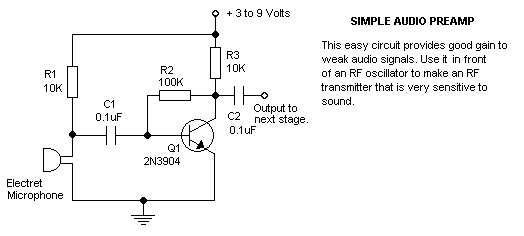

Step 2: Simple Amplifier 1
Simple preamp  for an electret microphone that you might find in some phones. Requires 3 - 9+ volts external battery or you probably could adapt a walwart.

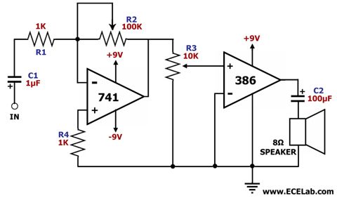

Step 6: Simple Amplifier 5
Yet another 741 audio amp.

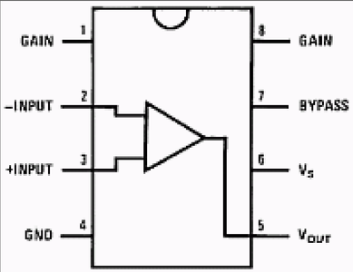

Also pictured is the pinout for the lm386

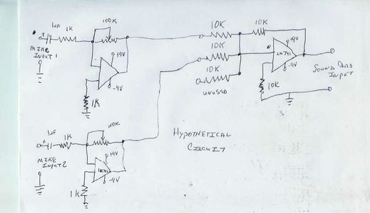

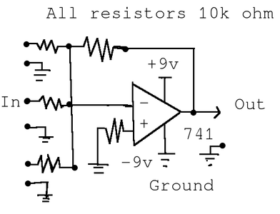

Step 7: Simple Mixer 1
Untested mixer: (Hook up several mikes to one input on computer.) (741 aka NTE 941m) Why do you need a mixer? You can use several microphones or sound sources with just one sound input on a sound card.  Of course, most sound cards have at least two inputs (aka stereo),

So far I have shown you five amps and two mixers. Now it is time to put it all together. We will be using 741 opamp (lm741 aka nte941) circuits for both the amps and the mix to make the project simple if all goes according to plans.
Under  construction.
mike > preamp  >
mike > preamp  >  mixer > soundcard.
mike > preamp  >
For purposes of this demonstration we will only be using two amps and one mixer. (I know nothing about electronics.)

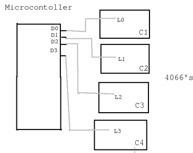

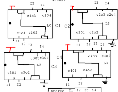

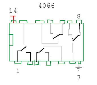

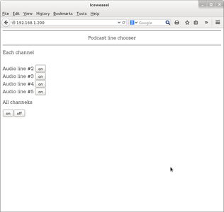

Step 11: Computer Controlled Input Switcher.
If you have a podcast it would be nice to be able to add or remove inputs. Can be very easy to do with the computer. remotely. The Rpi or an ethernet enabled arduino would be good for this. You will need cmos 4066 chips and 5 stereo input jacks to complete the hardware. More details later.
