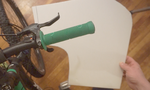

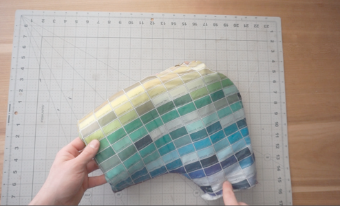

- Using paper held next to the handle bars I roughly sketched out the shape I wanted.
- The extra lines on the paper are where I thought I would need them but I wasn't thinking 3 dimensionally. The sleeve has to open up so I compared it to other jackets sleeves to get the width I needed.
- Cut the shape out and inspect it again before making some more adjustments if needed.
- Once I was happy with the shape I laid it over some corrugated plastic (cardboard is fine) and traced it with a half inch seam allowance. I made the spots where the cuff openings are extra long for now.
- Lay the pattern over some extra scrap fabric and cut out two pieces.

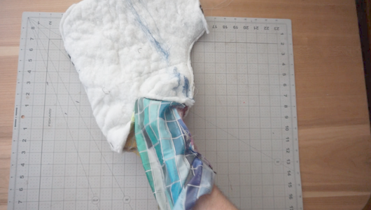

- Sew the sides together, careful not to sew the opening for the hands and handle bars (See Pic).

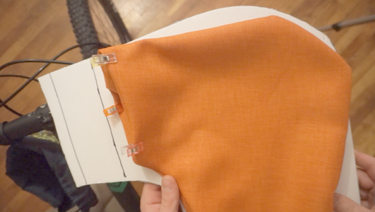

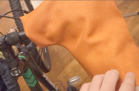

- Flip the mitten prototype inside out and fit it too the bike.
- The extra long cuff openings can now be folded inside to get the right fit. Pin or clip the excess to hold to position when you take it off.
- Take the clipped mitten and lay it over the template, mark your opening length and trim to it. Now you should have a pattern that fits you and your bike!

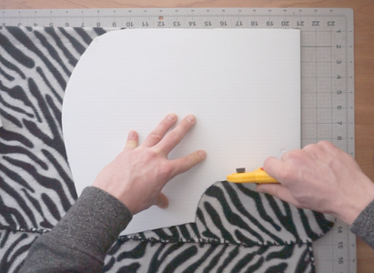

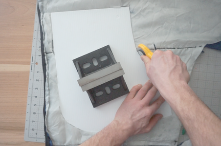

- Take your completed template and lay it out on top of your fabric. It helps to use some sort of weight to hold everything in place so it doesn't shift when you cut it. Especially when cutting slippery fabrics or multiple layers.
- Cut out the following for each mitten:
- 4 - Inner liner, I used a fuzzy zebra blanket
- 4 - Outer shell, I used Taffeta 15D since it is very water and wind resistant
- 4 - Insulation, I used some from a worn out sleeping bag but there are better options you can buy. I like recycling and it was on hand during the pandemic.
- Scissors will work but I really like a rotary cutter. If you need an excuse to buy one just think of it as a tiny pizza cutter and all the delicious things your'e gonna cook up with it.

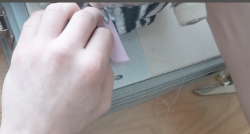

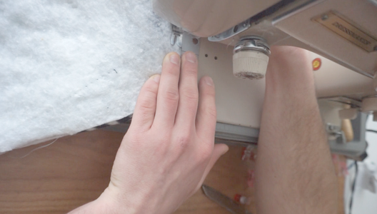

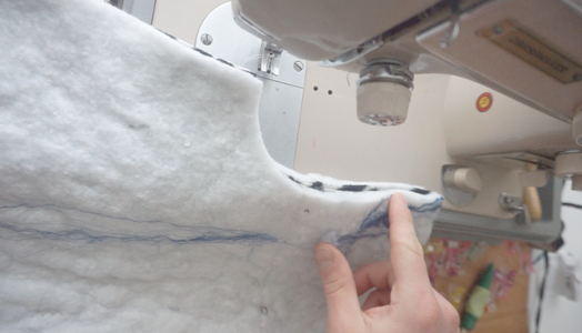

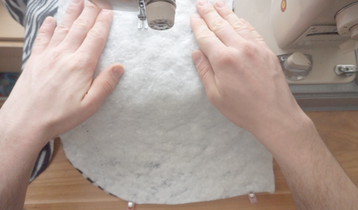

- First lay the insulation in place over the inner liner fabric and make a few stitches to hold it in place.
- I used the longest stitch and widest zigzag my machine could make. This helps to distribute the load to the insulation as it could pull out on a tight stitch.
- I tacked it in 3 places.
Repeat for the other half.

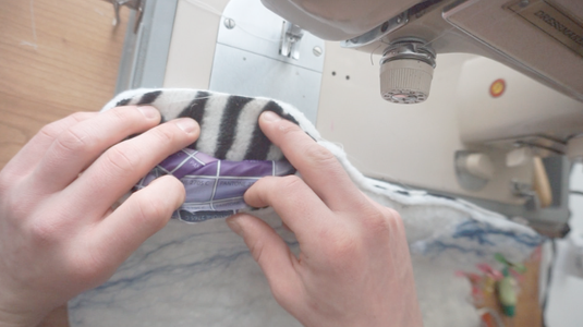

- Make a sandwich with your layers, we want the insulation to be the bread. This sandwich is getting a little thick but without the tight knit Taffeta in the mix it sews much nicer.
- Sew the outside edges that won't be cuffs to join the two halves.

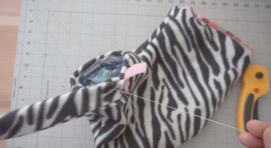

- Insert the Shell into the liner with the A side of your shell facing the A side of your liner.

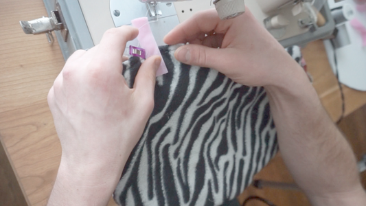

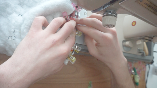

- Clip it together around one of the cuffs.
- Stitch the shell and liner together along the cuff line.
The advantage here is when I am connecting the taffeta to the liner I am only going through one layer of insulation and zebra fabric. The other method of construction required me to sew two layers of taffeta through two layers of everything else.

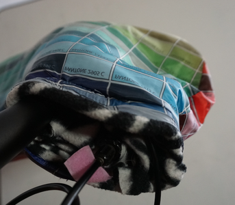

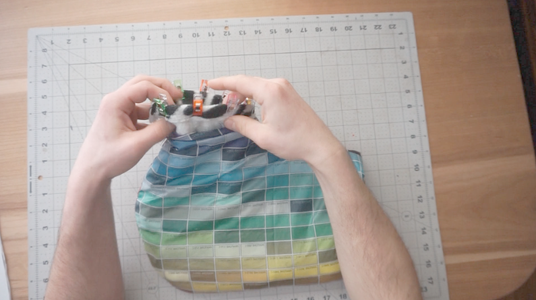

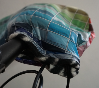

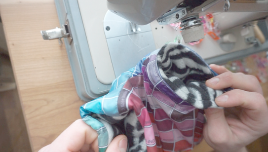

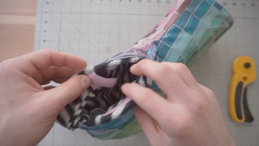

- Grab the shell from inside the liner and pull it out.
- Pull the shell over the outside of the liner. This is my favorite part about sewing bag and liners like this, feels like a grand reveal after all of the work you put in earlier!
- Fiddle with it till it fits well, it often helps to push seams from the inside out to fill them out fully.

I've used floating liners on bags before but not on something with two openings like this. I had to sew this cuff differently than the last, they don't match but they will still keep me warm.

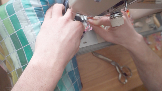

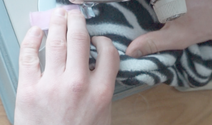

- I rolled the liner back then clipped it in place.
- I rolled the shell back and clipped it in with the liner. Doing it separately like this allowed for a more consistent seem allowance.
- Sewed the liner and shell together to complete the second cuff.

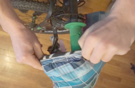

- Shimmy the mitten onto the bars and over the controls. Squeezing in the break lever might help with this.
- Tuck in the extra gap filling fabric in-between the bike and the mitten where the velcro won't pull it shut.
- Connect the velcro to close the remaining gap.
