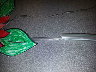

Step 5: The Wire
Cut 2 pieces of wire, 3x the length of the straw.Twist the
wire around each LED leg. Make sure the positive and negative sides do not touch. Then tape the wire down. Test
to make sure your led to make sure the circuit is working.
Step 6: Attaching the Neck Straw
Put a
drinking straw (the neck) through the plus wire and tape it down.

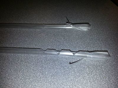

Step 7: Making the Arms
Take 2
additional drinking straws and cut little triangles out of them two – four
different places near one end. How many notches depend on how many times you
want the straw to bend.
Step 8:
Cut 2
pieces of nylon fishing line, 3x the length of a straw. Tie a knot in one end and put them through the
notched straws (the arms).
Step 9: Animating the Arms
Securely
tape the nylon to the straw. Tape above the knot. The knot will help prevent
the nylon from slipping when you pull on it to animate the arms. Test out your arms, a lot of people smile when they do this.Step 10: Attaching the First Arm Into the Body

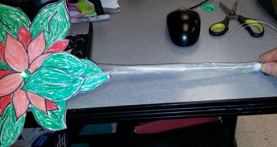

Step 16:
Tape your arm decorations and your battery pack decoration on.
Now try it out. Push the battery pack/switch to light up your puppet. Pull the nylon lines to animate the arms

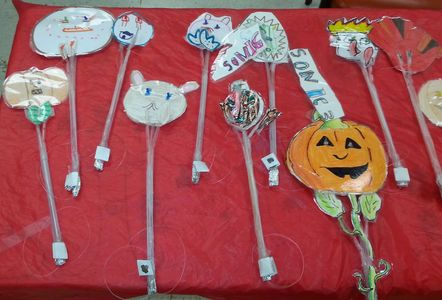

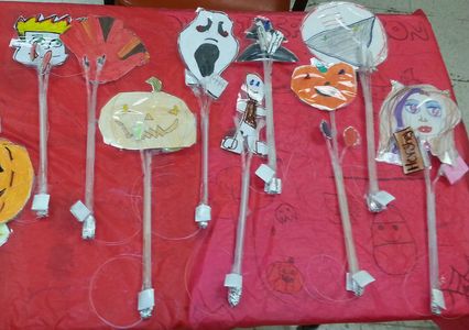

Step 17: Some Additional Designs
Some additional designs made by the members of our community center ages 6 - 18.
