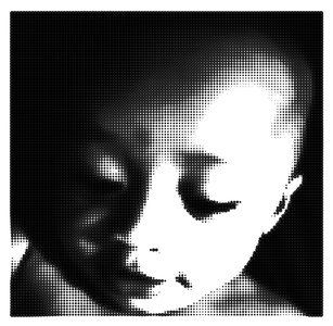

Step 4: Picture Version 0
The first version of the picture is a monochromatic rendering, in which the size of each dot is proportional to the logarithm of the color. I tried a few transformations and log was the most visually pleasant. You can see how the dots change in size and from the image.
fig = plt.figure(figsize=(50,50),facecolor='white')
plt.scatter(lY,lX,s=5000*np.log10(np.array(lS)/100+0.01),alpha=.85,edgecolors='none',c='black')
plt.axis('off')
plt.savefig('Art_v0.png',dpi=300)
