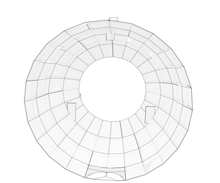

Step 1: Printing the Bottom
Print the bottom from the file.
I printed the case with Printrbot simple makers kit. Cura 15.02.1 is the program that i am using.
The inner mesh was printed just to keep the print in place. The inner mesh can be cut with knife.
Print took about 2 hours.

Step 2: Print the Top Part
Make sure that the part is in the same scale as the bottom part is if you needed to scale it down or up.
The procedure with the top part is the same as the bottom part.
Cut the excess mesh from the print.
