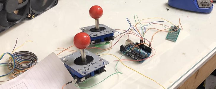

Step 2: Circuit Wiring Diagram
This circuit diagram illustrates all the wiring connections between the arduino, radio module, dip switch and arcade joysticks.
As you can tell with the before and after pictures, the initial circuit was a mess until everything was soldered.
Step 3: More Circuit Photos
