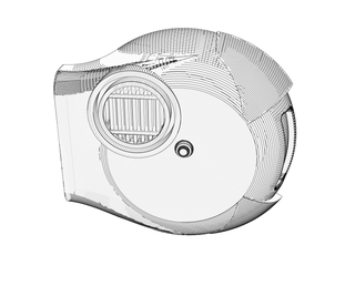

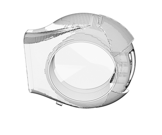

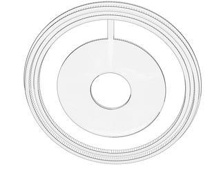

Step 2: Printing the Parts
I designed this for a plastic tube with a diameter of 60 mm. So if your tube is bigger, just calculate how much bigger you need to print the parts.
Print the TOP and BASE in white.
Print the RINGtwo times in yellow (or blue)
I also added the 123D-Design files, so you can change things if you want to.
[I used a Robo3D printer with PLA]
