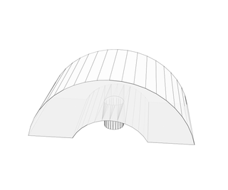

When it comes to parts that need to be 3D printed, there are only five of them. These include 3 separate pieces to make the poke ball that sits on top, the stand, and a customized lid for the box the pokestop sits on top of. The reason there are three different pieces for the poke ball is because I wanted each half of the ball to be a different color that looks as much like a basic poke ball as possible. The files for each of the parts are attached and the colors I used for each parts is in the file name.

Now it comes to attaching all the 3D parts. This is fairly simple. For the pokeball, each of the halves has a small pole sticking out and each it goes into the black cylinder. Apply epoxy to the poles before sticking them in to ensure that they won't come apart. Next, there should be a long pole coming out of the bottom half of your now complete poke ball. Run the pole through the middle of the stand then through the small hole on the back side of the box lid. This will line everything up so that you can apply the epoxy to the bottom of the stand and stick it in place on top of the box lid. Just make sure you keep the epoxy far enough away from the hole and pole so it doesn't get stuck. Furthermore, the pole has a small hole at the bottom that should fit around the stepper motor so the motor can spin the pole. You can add some glue or tape here to ensure they stay together but I find it unnecessary. Finally, you can either tape or glue the LCD and proximity sensor to their respective holes of the box lid. I chose tape instead of glue in the event I wish to reuse these parts for a later project.
