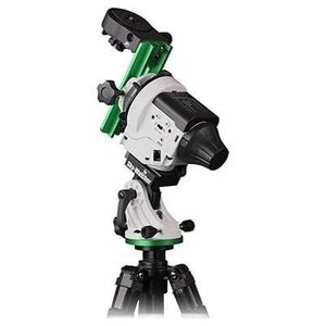

Introduction: Polarscope Illuminator for the Sky-Watcher Star Adventurer 2i
The Sky-Watcher Star Adventurer 2i is a tracker for Astrophotography. It can be used with a camera to track stars, the Sun or the Moon across the sky.
If you read the online reviews of the tracker you will notice that there are a few niggly little inconveniences with the design. One of them is the polarscope illuminator which is a separate item that contains a battery and red LED. This is rather inconvenient as it is fiddly to fit and use. It is also easy to forget it, loose it or drop it!

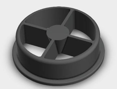

I measured the polarscope hole diameter and depth, designed it with the free DesignSpark Mechanical CAD package and made the illuminator body using a 3D printer. It would also be possible to make one to fit using plastic and conventional means.

The 3D printer compatible stl file for the illuminator body is included here:
Step 1: 3D Print the Holder and Attach the Luminous Tape
After 3D printing the illuminator body, the 6mm disc of tape and 1mm wide strips are attached. The illuminator is then slid into the aperture at the end of the polarscope and gently pushed in. It is designed to slide in to the locking ring of the lens and not touch the lens.
Depending on the tolerances of your 3D printer you may need to scale the stl file in Cura so that it is a sliding fit in the polarscope aperture without being too tight to fit, or too loose to fall out.
