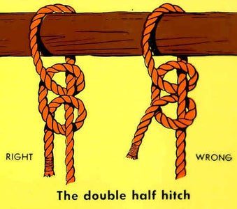

Next we have to tie the six meters of nylon rope to the bungee I found the best knot to use was a double half hitch. Then we just clip the hooks on the bungee to the hooks on the shed.
