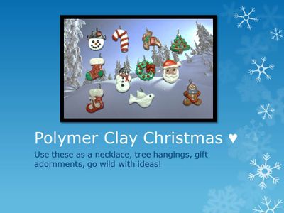

Introduction: Polymer Christmas Characters
Use as ornaments on your tree, your gift, or yourself!. Attach tree hangers, pins, magnets - wherever you want them to visit!
Gather up the holiday color clays and lets get started.

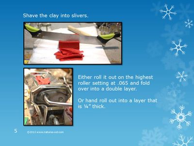

Step 4: Start Rolling the Clay.
If you use a pasta/clay rolling machine, roll a layer of clay at the #7 setting (.0065 thick). Then fold it in half achieving a 1/4" thickness.
If you're rolling by hand, roll out a layer approximately 1/4" thick.

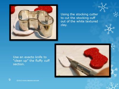

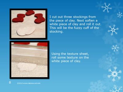

Step 6: Make Multiples to Save Time.
I cut out three stockings from the piece of clay. Next soften a white piece of clay and roll it out. This will be the fuzzy cuff of the stocking.
Using the texture sheet, roll some texture on the white piece of clay.
Using the stocking cutter to cut the stocking cuff out of the white textured clay. Use an exacto knife to “clean up” the fluffy cuff section.

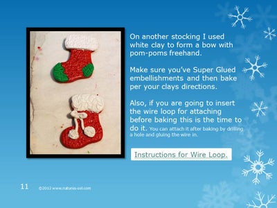

On another stocking I used white clay to form a bow with pom-poms freehand.
Make sure you’ve Super Glued embellishments and then bake per your clays directions.
Also, if you are going to insert the wire loop for attaching before baking this is the time to do it. You can attach it after baking by drilling a hole and gluing the wire in.
Instructions for Wire Loop.
The above link will take you to Fire Mountain Jewelry which has great instructions for making the looped wire.
I then used green clay to form stocking “patches” for the toe and the heel.

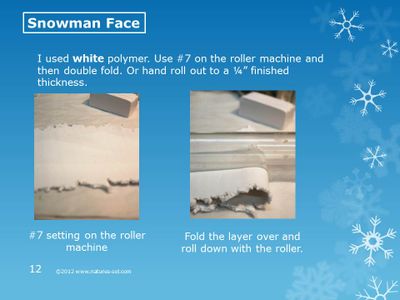

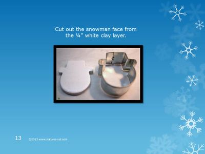

Step 8: Let's Get Started on Snowman.
I used white polymer. Use #7 on the roller machine and then double fold. Or hand roll out to a ¼” finished thickness.
Cut out the snowman face from the ¼” white clay layer.

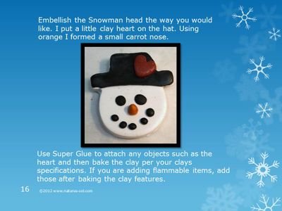

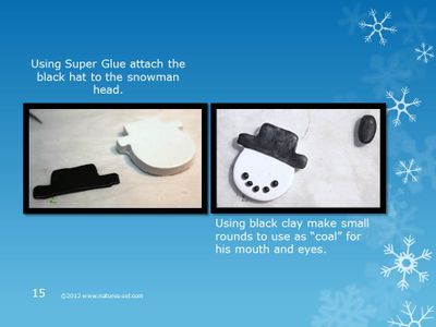

Step 9: Top Off the Snowman Face.
While we use 1/4" thick layers to make the ornament, when making embellishments we use the thinnest possible setting. The clay should be paper like in thickness. Make sure to Super Glue to embellishment to the clay before baking.
Step 10: He's a Happy Guy.
Embellish the ornaments however you would like. Use sparkles, gems, or anything else. Make sure if the embellishment is flammable or meltable put it on AFTER baking. The finish you use will complete the attachment of the embellishment.
After firing the clay and attaching any other decorations - finish the ornament in Mod Podge or any other finishing product.

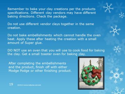

Step 12: Some Finishing Notes.
Remember to bake your clay creations per the products specifications. Different clay vendors may have different baking directions. Check the package.
Do not use different vendor clays together in the same creation.
Do not bake embellishments which cannot handle the oven heat. Apply these after heating the creation with a small amount of Super glue.
DO NOT use an oven that you will use to cook food for baking the clay. Get a small toaster oven for baking clay.
After completing the embellishments and the product, finish off with either Modge Podge or other finishing product.
