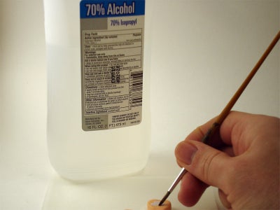

Step 4: Brush on Rubbing Alcohol
Use a soft paintbrush to paint a small amount of rubbing alcohol onto the back of the paper. Be careful not to move the paper, since this can cause smudging. Let the alcohol dry completely (til you can no longer see the letters through the paper), then repeat this step twice.
If you prefer, you can leave the transfer sitting overnight instead of using rubbing alcohol.

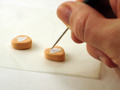

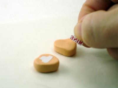

Step 6: Trace Letters
The messages on real candy hearts aren't just on the surface -- they're actually embedded in the heart. Here's how to get a similar effect on your polymer clay hearts.
Brush the transfer lightly with rubbing alcohol once more. You should be able to see the letters through the paper. Use a toothpick or needle tool to trace the letters, creating an indentation in the clay. This step often makes it easier to remove the paper as well: as you're tracing the letters, you may see an edge start to stick up. Once you're done tracing, use tweezers or a needle tool to coax the paper up the rest of the way. Your message should be transferred onto the clay.
Be careful not to touch the transferred letters, as the ink is still wet and will easily smear. If you're not in a big hurry, I'd encourage you to let this sit a few hours til the ink dries. That'll help prevent smearing. But if you're in a hurry, continue on and just be really careful not to touch the ink.
