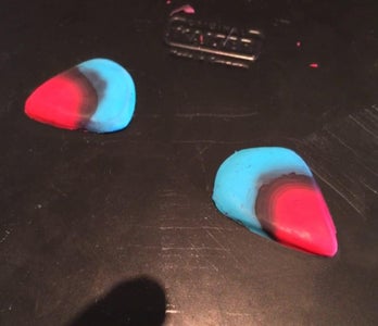

Step 4: Make the Background
  1. Cut each skinner blend in 2 length wise.
  2. Gently roll them flat.
  3. On the peppermint blend gently push the blend to wrap around your finger (or a small rolling pin) - creating an indent in the black.
  4. Press it onto the baked backing.
  5. Add the red blend stretching it slightly to create a 'candy corn' look
  6. press the cookie cutter over the form to trim the edges.
  7. smooth down the edges with a clean finger
  8. bake again.
