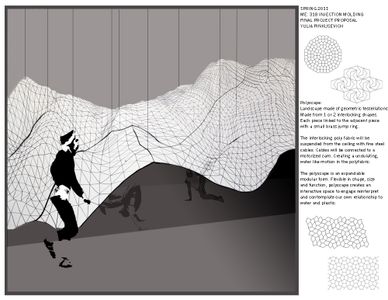

I set off to design a kinetic sculpture titled Polyscape as a "floating island" made out of recycled polypropylene plastic, which is the same material used in making disposable plastic bottles and bags. I was interested in investigating the natural properties of recycled plastic as well as the injection molding process therefore it was important for my design to incorporate modularity, semi translucency and the sculpture to be as light weight as possible. Most importantly Polyscape was designed to be flexible in shape, size and scope in order to be exhibited in a variety of settings.

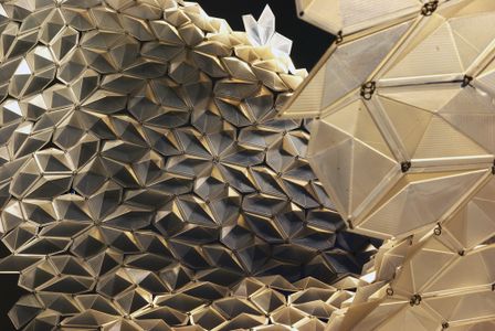

The completed form is a tessellated pattern of interlocking irregular pentagon shapes. In order to achieve this I developed a 3D tile that can be interlinked together to form multiple types of patterns, such as linear grid forms, interlocking hexagonal forms as well as other less regular patterns.

Due to my injection troubles, most plastic pieces had to be post processed. Each pentagon had to be cut away from the flashing and runners Each piece was then linked together with (17gage 1/4" diameter) aluminum rings to create hexagon flowers and two other shapes. Each shape had to be joined together to form the tessellated polymer fabric.

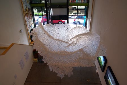

This assembled poly-fabric grew to be 14 x 14ft approximately and was suspended from the ceiling with monofilament looped through pulleys. Some of these lines got attached to a motor activated by Arduino electronics with sensor input. The fabric is designed to move such that it mimics the motion of water. Using motion sensors input to drive the motors Polyscape undulates when humans are present. This invites people to explore and interact with the fluctuating seascape from above, below and all around.
Step 4: Exhibition (Final Form & Concept)
POLYSCAPE is a project which merges art, architecture, engineering and ecological literacy. It visualizes complex pentagonal tessellations that create magnificent interlocking forms, therefore addressing pattern, repetition and mathematics in modular design. POLYSCAPE is also unique in its design because it is flexible in shape, size and scope. This allows the piece to be transformable for its environment, expanded or collapsed, installed with minimal specifications and be almost maintenance free.
