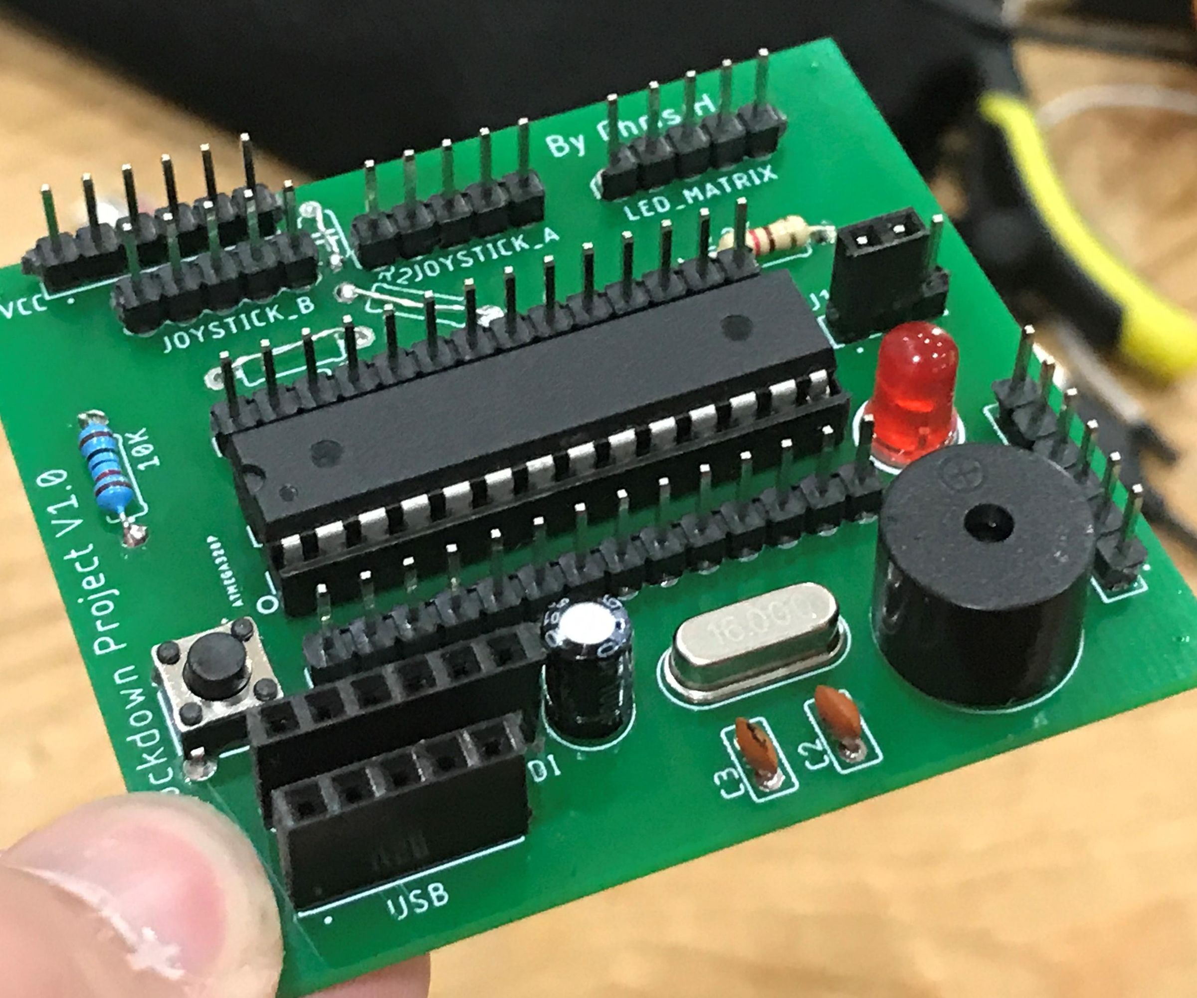

Step 3: Alternative Wiring
After wiring it with an Arduino UNO to save space I decided to put the Arduino IC from the UNO on the breadboard with a 16Mhz Crystal Oscillator and a pair of 22pF capacitors from each side to ground. I feel this was a worthwhile modification as it makes the project look neater and more finished however you do have to use a USB FTDI programmer to update the program.
