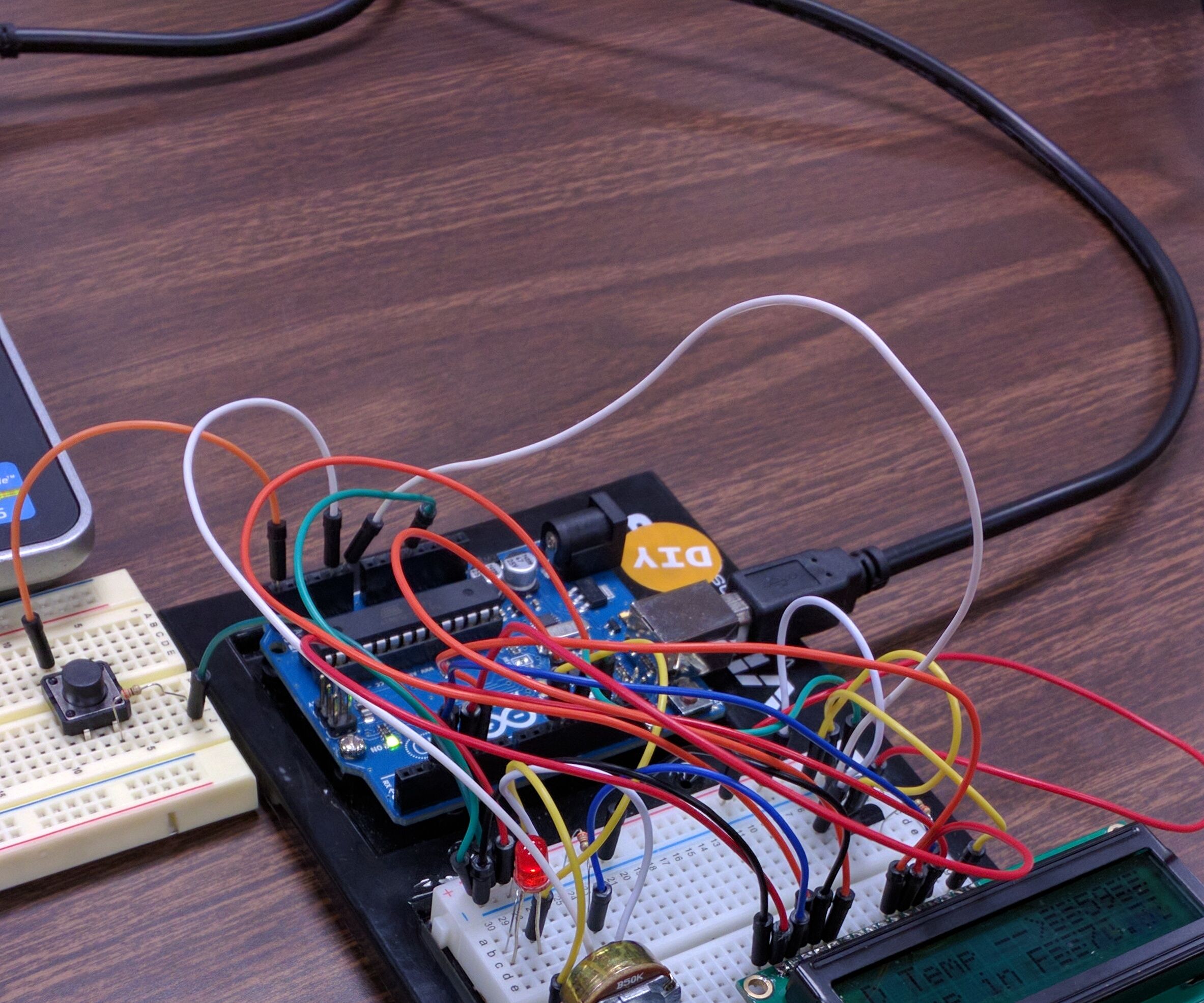

Introduction: Pong With Arduino and Processing
This is using an arduino with meters to control the paddles on processing.
This will be using serial ports to be read by processing sent by arduino.
Step 1: The Setup
Materials:
  • Arduino
  • BreadBoard
  • Jump Wires
  • Potentiameter
  • Processing
  • Arduino IDE
